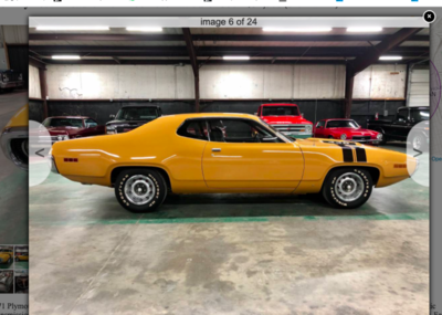

I don't mean to criticize but: not original motor, wrong rear bumper tape treatment, wrong door panels, no Road Runner emblem on quarter panels, ripped rear seat cushion, wrong a/t shift handle, wrong front stabilizer bar. Did I miss anything? Well, not sure that really duplicates the factory Bahama Yellow color either.
No spare tire/wheel, no jack, no power steering, no power brakes, no disc brakes, no A/C. I would keep looking.
The add mentions "fender tag in place". It is, but held on by two rusty screws!

it's a dealership. lipstick on a fat ugly chick. the picture of the axle covered in dirt and gear lube says it all
I'll add. Wrong valve covers, master cylinder, horn. GTX hood stripes, door panels. Incomplete bumper black out. Incorrect grill paint.
....but its got new clamps on the front sway bar...
:lol:
That place is not known for high quality cars, they usually have entry level stuff, non matching and lesser quality.
This might be dumb question, but I've never seen a '71 b-body with that shifter. E-bodies only. Am I missing something?
Don't think it originally had power steering or power brakes. They were not part of the RR model. They were options.
This is a car ment for a person with more dollars then Sense (cents)
It looks pretty and that's what will sell it . I wouldn't buy from them just assume it's full of mud and has a cheap paint job that will last a year or two .
These people are insane
this picture tells a lot about how this entire car was " restored " .
look at the body floorpan.
Yep, the only 440 available in the 71 RR was a V code six pack.
Kind of a hodge podge between a RR and a GTX.
I agree, 10-15K and drive the crap out it.
Since we're throwing darts tonight...that exhaust system looks like crap.
