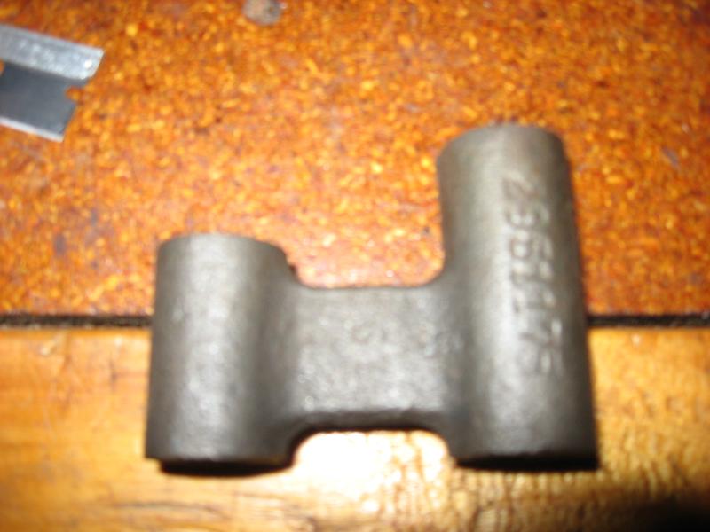

I noticed that fan belt was being dug into by the alt bolt a few years back and upon investigation I found THIS item installed as a 'spacer' behind the alt.

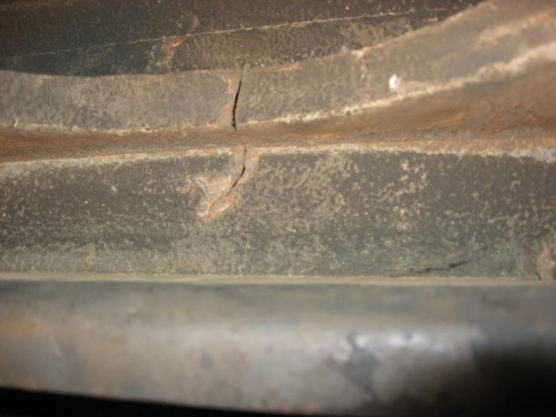

Tonight I went to put some new rear shocks on her and I found this lovely item in the cross frame:

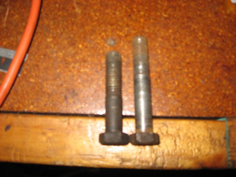

I suspect the crack was created due to the fact that these bolts were use to hold the upper shocks in place. Sorry for the crappy photo but yes, there are two different length bolts with 2 different types of threads:
I theorize, that since one of the bolts wasn't tightened all the way, the upper shock bolt was moving and flexing around which in turn looks like it was flexing the frame and created the crack as the crack is smack dab in the middle of the frame. Obviously it's not the end of the world as I can and will weld it up.

Well, hate to see these kinds of things happen to good cars. FYI, that crack in the cross member is typical of having had air shocks (at one time). That piece was never designed to support the car's weight and will crack like that when coil spring (overload) shocks or air shocks are used to jack up the rear for that cool hot rod look.
Ahhh...thanks Badvert. I did not know that about the air shocks but it makes sense!

That first item IS supposed to go as a part of the alternator attachment on a non-air big block. I have a couple of those in my parts box from cars I've parted over the years. And since you had small block pulleys, that was the cause for the misalignment, not that "H"-shaped part.

Hmm... I've had two non-air 383's (this one and a '67 Chrysler) and neither of them had that part on it. What is the 2nd part of the "H" for?
Parts book lists it as "Fan belt idler puller bracket spacer" from the casting #

Ahh, thank you. So if what I see in the picture is correct, then it is a Mopar part however it has no use on my engine. First off, my engine doesn't have an idler. Secondly when Helen Keller was working on my car, he/she/it installed that item it behind the rear mounting ear of the alternator using it as a spacer. From what I see, that part doesn't not belong there!! Ultimately I resolved the issue by getting an alt spacer kit as even the spacer between the alt mounting ears was missing.
