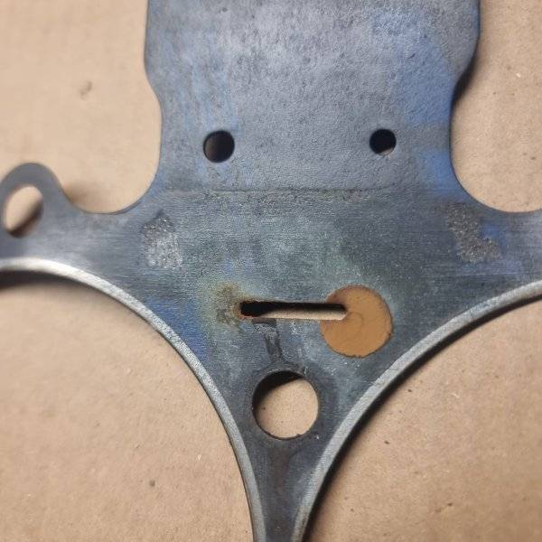

Looking for some advice from the knowledgeable people here.
Have had the heads removed from 60" over 440 after confirming engine had a combustion leak, after eliminating other overvheating causes.
The engine also had some oil in coolant but no coolant in oil.
Was hoping the head gaskets may have been blown out or there were were cracks in the heads.
There are however, no breaks or obvious indicators of leaks on the gaskets.
I have had an opinion from an engine builder who said the standard felpro gaskets can leak ( engine is supposedly 9.5.1 comp but was beat on by previous owner,who claimed he used to rev to 7k)
The engine guy said this may be the issue but it's a crap shoot either way without an obvious crack or break or discoloured gaskets, that the leak is in fact caused by poor head sealing.
The heads were not professionally surfaced when they were previously removed. There was also some head bolts that didn't seem as tight as would be expected, so thinking the heads may not have sealed properly.
My question is what are the chances there is crack in one or more of the bores, or is a combustion leak more likely to be due to bad seal on the heads I can't see any cracks with the engine in the car.
Are cracked bores something that anyone has seen before? I want to avoid pulling the engine out if possible, but just hoping someone can offer some advice.
I forgot to.mention the engine has only done a few hundred miles and has had over heating issues from the time it was installed after previous owner freshened up the engine.

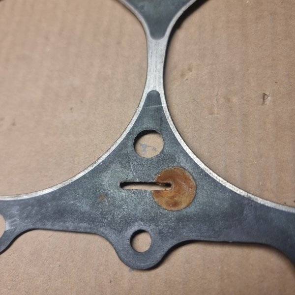

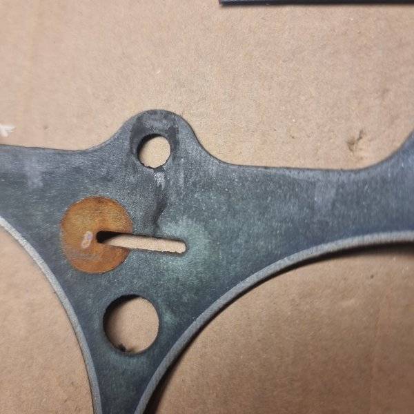

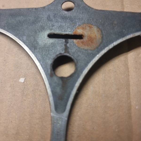

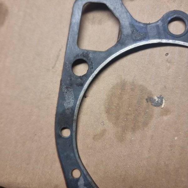

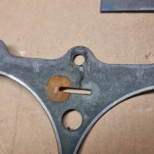

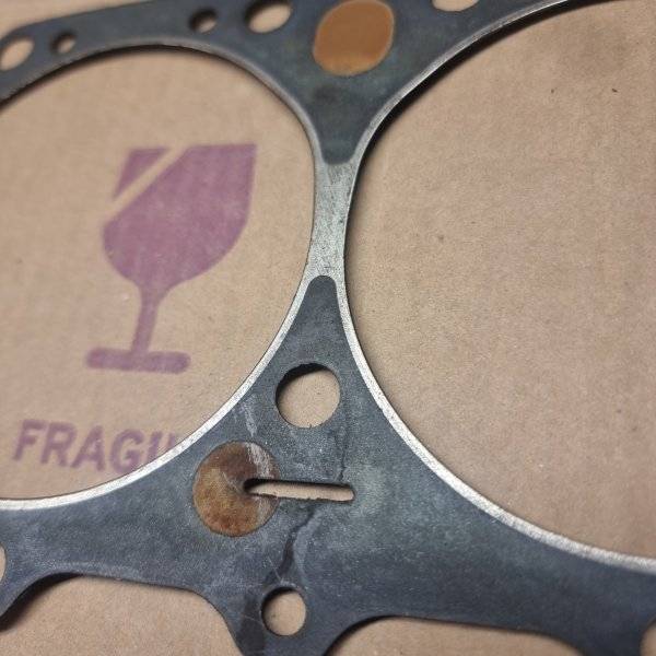

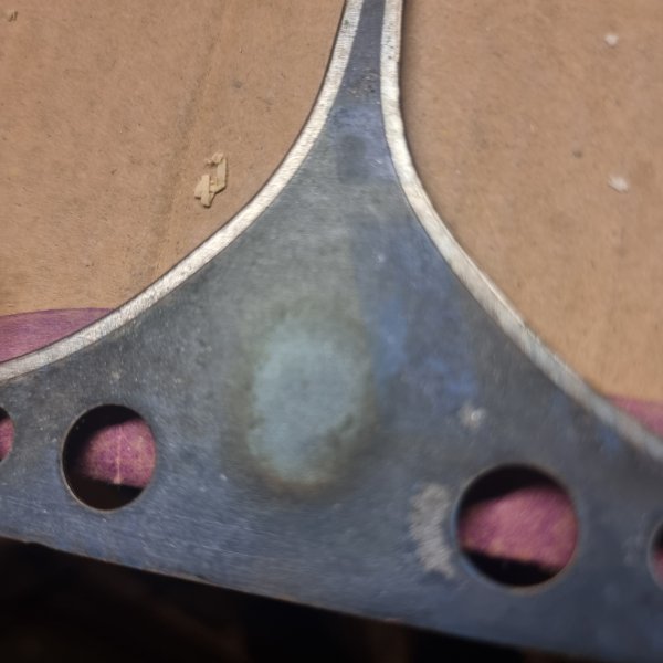

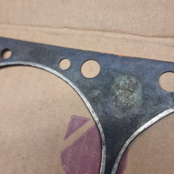

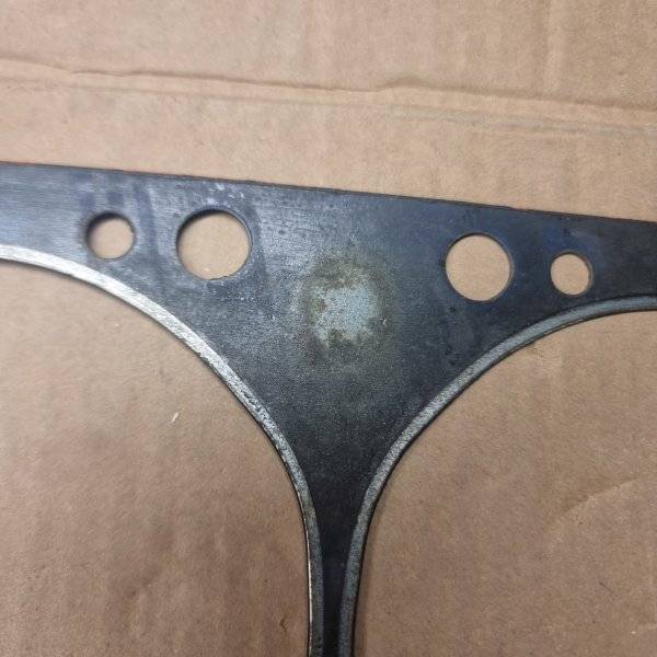

Have included some pics of the gaskets, there are a few odd stains on them but hard to be sure what's what.
Thanks in advance

In pics: 1,2,3,5, and 6, there are swirl marks indicating the heads WERE milled. In pics:3,4,7,8,9, and 10, the marks are horizontal (left to right) indicating that the block was not cut. Look at the heads and you will see the swirl cut marks from milling. I am curious about the large black marks going from the oil galley (rocker arm oiling) hole to the water slot. That is the likely "oil in the coolant" path. Oil pressure vs. 16lb coolant pressure; oil is going to win the pressure battle. As far as the loose head bolts, you said there were overheating issues. That is going to crush the head gasket and after it cools, there will be a loss of bolt clamp force and some bolts will be easier to remove.

There are odd looking marks on the gaskets emanating from coolant holes. Crack in the deck?

Was hoping someone could make sense of the gasket blemishes. Definitely looking like the heads weren't sealing. Thanks for the info.

Thanks for the info, Was hoping someone could make sense of the gasket blemishes. Definitely looking like the heads weren't sealing.
Took the heads to machine shop today and the guy said the heads were roughly milled and not surfaced sp you were spot on.
