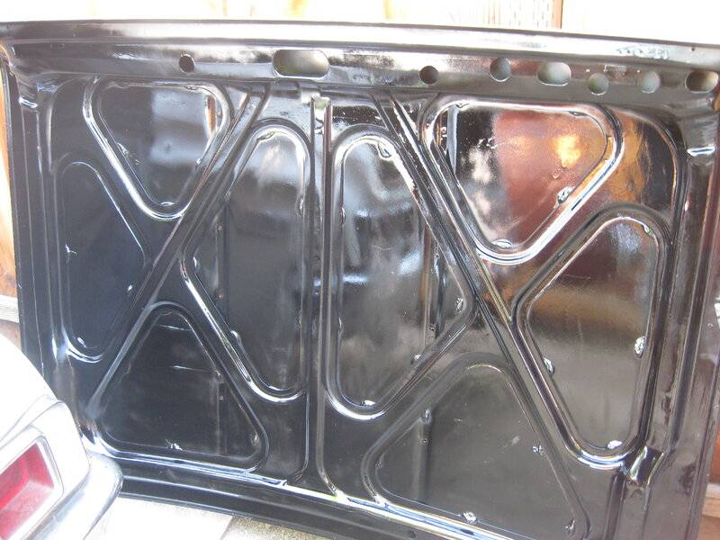

I'm painting my Polara, so I'm looking for input from the paint pros here on the forum. I've painted many engine compartments and wheels, but not a full car yet.

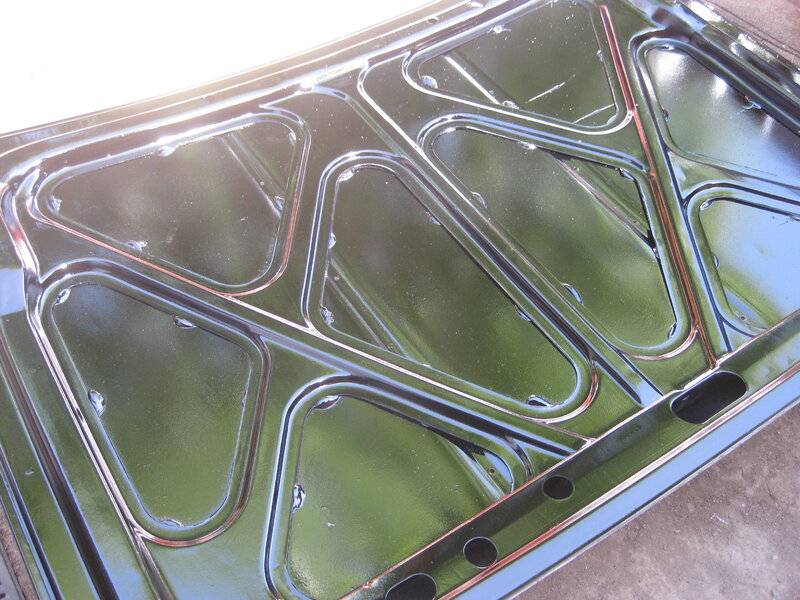

So I started with the trunk lip and underside of the lid. I had a hard time seeing the markings on my mixing cup because I was reusing it. In short, I didn't mix in enough activator. Needless to say the paint never really hardened. After a month, the paint is still tacky.
Here's my question.... can I just (properly) remix and shoot right over it? Or, do I have to wipe it all off with lacquer thinner and basically start over?
I wouldn’t spray over it since it never hardened properly if you do the top coat that hardens will probably crack from being on top of the soft paint. Just do it right and start over,
I agree ,if you paint over it I think it will look like orange peel
I failed to state that this is single stage urethane. But yeah, I guess you're right.... I will wipe it tomorrow. I was just going to put lacquer thinner on a rag and wipe it. Do you agree with this process, or is there a better way?
Good Luck... It's gotta come off, painting over would be a disaster & I seriously doubt it's gonna just wipe off....
If all you shot was the inside of the trunklid, consider it a cheap lesson, and fix it right. It could have been MUCH worse, you could have shot the whole car.
I think I would try using some aerosol aircraft paint stripper. that stuff is awesome and it wipes easy. I bought a car once that someone had basically done the same thing only with Rust-Oleum enamel, it never cured. you talk about a mess.
