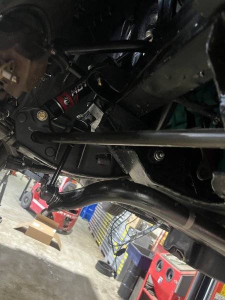

Worked on getting the Gladiator or JL Wrangler sway bar modified. Had to cut 5” off both ends so it lined up right. Then Put it in the press to crush the ends which was extremely scary and sketchy. Then we ate up 7 drill bits for the new holes. Coworker was able to recommend endlinks off a 2018 Toyota 4Runner. They work nicely maybe too long. Gotta check it out at ride height.
Heres the Jeep bar vs stock and it installed.

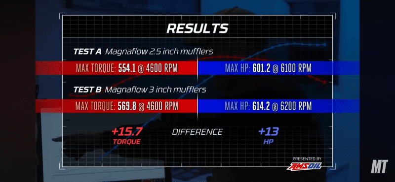

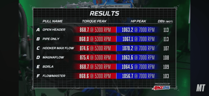

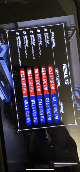

I hear what you're saying. But you've probably underestimated your hp loss by 10X. Just trying to help. Albeit late.
Here are some interesting test results from engine masters. I cant find all the videos however, They also confirmed bashing your headers to fit does not effect hp. As well as exhaust cut out gains regardless of where they are in the exhaust system. The x pipe vs h pipe was 1hp loss with an x pipe.
In regards to my wonky x-pipe - the test between single exhaust vs dual is significant comparing a 90 degree merge vs Y merge. Basically 2hp. The black widow x pipe merge hole is massive and free flowing. The fact that I have all straight through or free flowing mufflers and dual 3” exhaust with cut outs. Is more flow than my rv 440 or stroker build will ever need to be driven on the street and occasionally raced.
