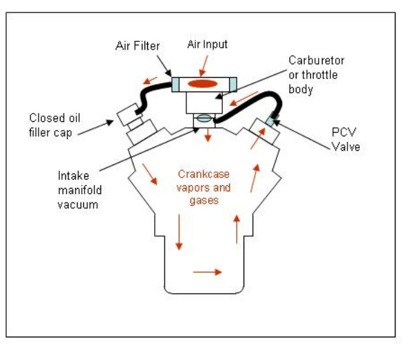

Here is the air flow diagram. The only difference is mine (and probably yours) will be an open oil filler cap as opposed to drawing air from the air cleaner (closed system pictured below).
Ranger described the theory of a PCV system.

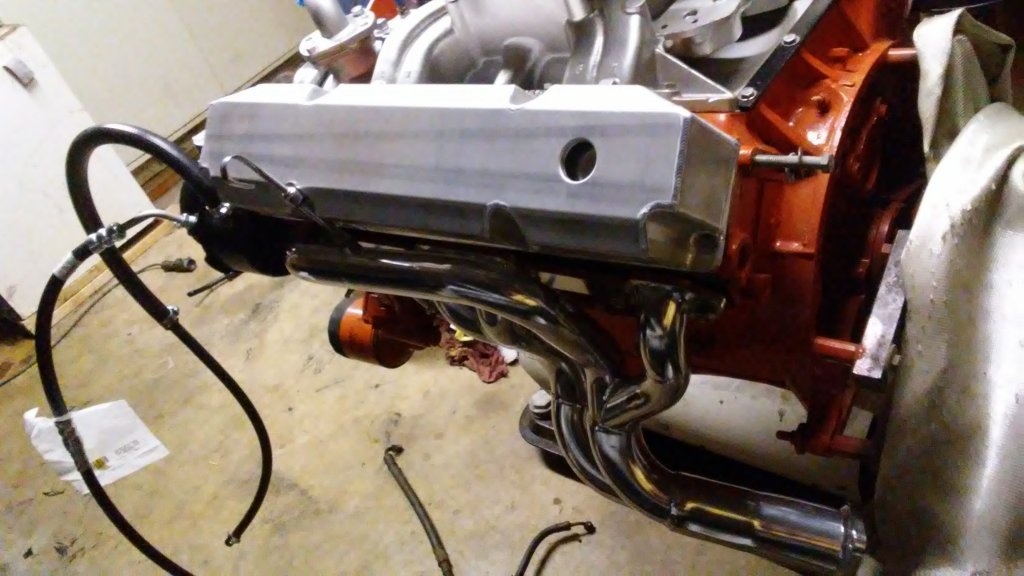

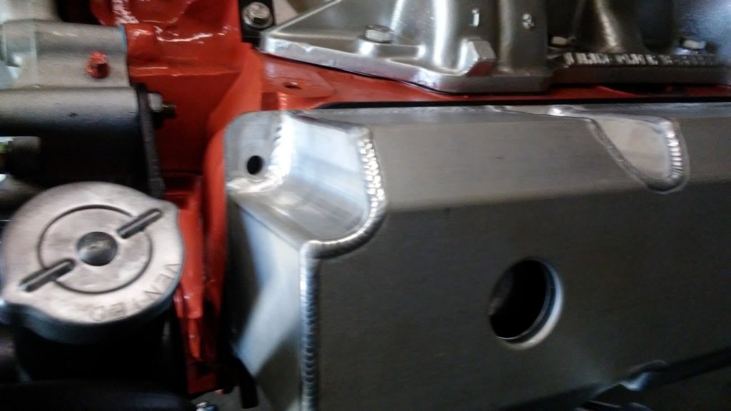

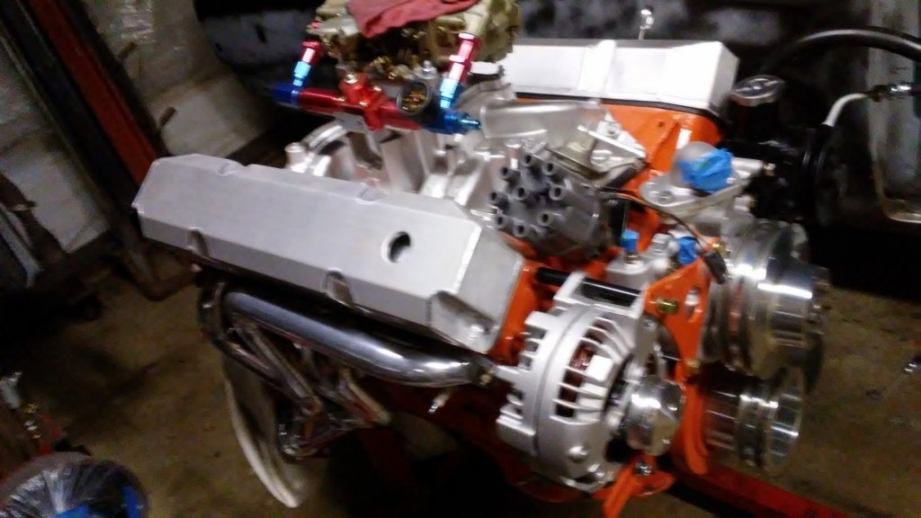

So from what i"m reading, if i ran a pcv and breather, could i put either in either side ?
IIRC you are using custom valve covers with no spark plug wire looms attached to them . Swap sides and then your drivers side oil fill and fresh air will be towards the front , and your pcv will be on the passenger side towards the back as Ma Mopar intended..........................MO
Oh. Duh. Thanks. I didn't realise they had been put on backwards.
Just a thought..are the holes in the valve cover ,for the grommet, the same size on each side? The grommet is probably different size inside diameter between the oil filler-breather and the pcv valve............................MO
Can't speak for your valve covers, but mine are the same size and interchangeable.
My guess is yours will be the same.
Yes, mine are the same diameter on both sides. If memory serves, when i had a cuda, it was the rubber inserts that are different diameter.

If they are the same size, then the rubber insert should fit either side should you want to swap sides.
And, be sure there is a baffle under the PCV valve so that it doesn't ingest oil instead of vapors...VERY important.
IIRC you are using custom valve covers with no spark plug wire looms attached to them . Swap sides and then your drivers side oil fill and fresh air will be towards the front , and your pcv will be on the passenger side towards the back as Ma Mopar intended..........................MO[/QU
Just discovered these aren't made to swap sides. Anyone want to buy 'em ? Lol.
WTH- can't swap sides? It's just a bigblock! It just keeps getting crazier all the time.
