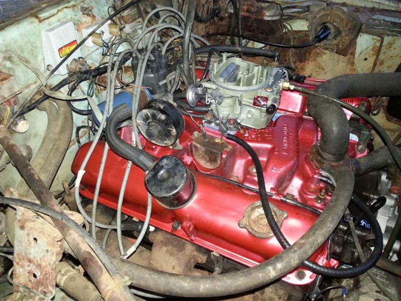

X2 solve the causing issue first are you using a PVC to carb base or manifold? do you have air breathers on the valve covers?
K great, the PVC goes from crankcase to carb. No air breathers, are they bad to use?
No breathers at all? Well, there's one of your issues....
PVC should be in one valve cover and a breather in the other.
Sorry, do have a breather that goes to intake but would like to switch it out.
Breathers (PCV) allow pressure that has built up in crank case to vent.
Essentially, positive pressure builds over usage.
The PCV valve or Positive Crank case ventialtion allows built up gas to escape.
Ok, thanks for the pic. It looks like you have the proper pieces.... Thinking you may want to remove the breather and hose it out with some brake cleaner. Also change out the PCV valve.
Remove the oil cap while the engine is running.... Do you see smoke coming out of the oil fill hole? If so, it's time for some new rings.
