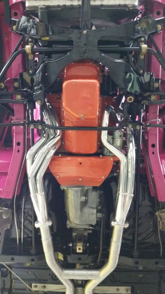

Trim it as we talked about. The pan hasn't been touched on this motor in 21 years. This picture was from 2015, looks the same today.
Doug
