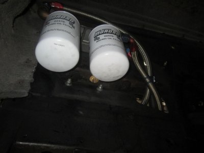

I would like to add,,,if you have an HP system that goes to 70 or 80 lbs cold,the filter goes into by-pass mode and does not filter.Know what your oil system flows and pick your filter accordingly.My Milodon oil system moves 19 GPM
