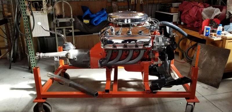

if I had a hemi i'm storing for 2 years i'd build a stand with a battery and a key switch and radiator just so I could hear beautiful thunder every month
like this? just might do that....:thumbsup:
