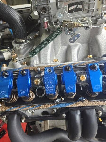

Roller rockers messed up
I don't know what cam you have but my howards roller (.525 235@50 on 109), i get 8-10hg at idle, have run smoke through the intake to make sure i didn't have leaks just in case, it is what it is..
The 15 mins for lifter to pump up scares me though but i'm not an expert and someone else will chime in i'm sure. If you are saying it's tight and hard to start after running (due to slow turnover/tightness?) I would cut the oil filter open before i ran it again just to see if anything is in it. It's like $10 that might save you a lot more in the long run..
Im sure it's fine. As a run stand isn't enough to seat the rings, most likely still breaking in. I checked all clearances during and all was good. But ill do that for peace of mind anyway.
I did have an electrical issue at first. The solenoid was wired wrong and I burned out 2 cut off switchs. It's changed and wired proper now, but I suspect I need another solid ground to the engine anyway. Maybe the the culprit. But ill report when I open the filter.

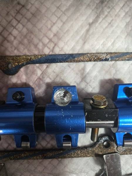

Update Sept 30th.
Found the smoking gun. Cheap chinek rockers. Not only dont fit but strip out.
Had one last year in 1 440 I posted. I caught it and installed a helicoil. But this one's pouched.
So ill install stamped to finish the breakin. Obviously that intake lobe was missed a bit.
Camera inside seems to show all shavings were at the top. I'll cut the filter just to make sure.

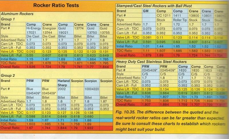

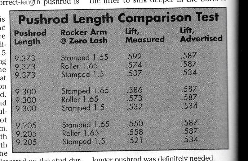

Rocker geometry is a can of worms. Many subscribe to the centered valve tip pattern theory without thinking about what happens on the prod side. D.Vizard did some extensive testing.....& ended up with a dogs breakfast. The second pic is how prod length affects lift.

Hi guys! Final update.
I've contacted Proform and await their reply for a replacement rocker....
Anyway, ran stamped and were cooking now. Pulled filter and would appear that it worked. Oil inside was clean and the outside of the filter kept the debris out. So ran it and we seem to be good. Last run i was able to get 12-13 hg of Vacuum which is within spec for the cam. Now to dial in the timing and carb to get a bit leaner AFR. Time of course will tell, but all my local engine guys support say I should be fine especially as it was aluminum debris. More run time will help to seat the rings and should be fine.
