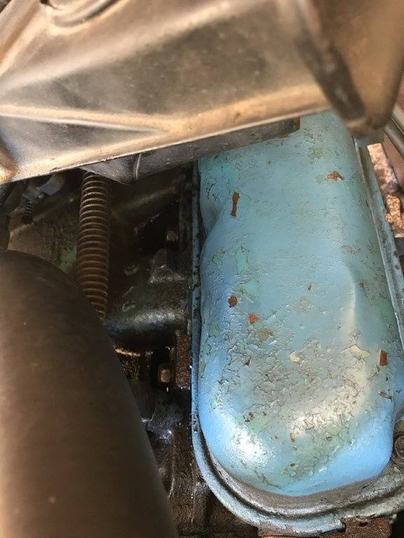

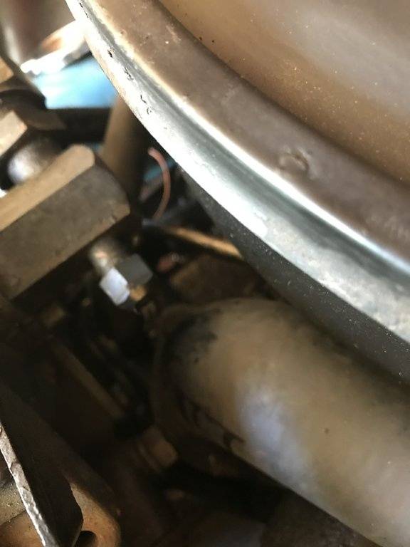

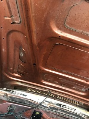

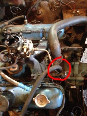

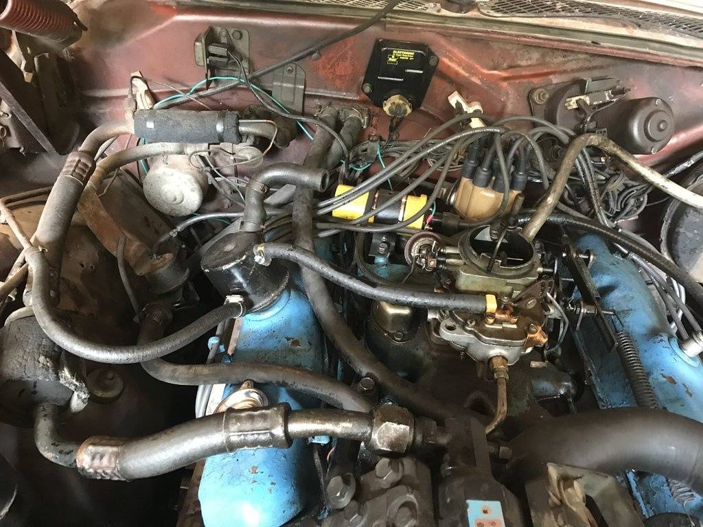

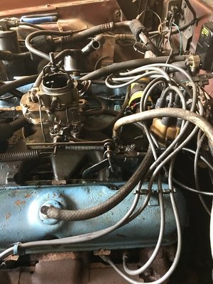

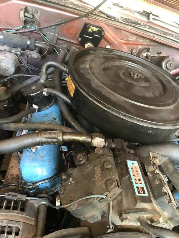

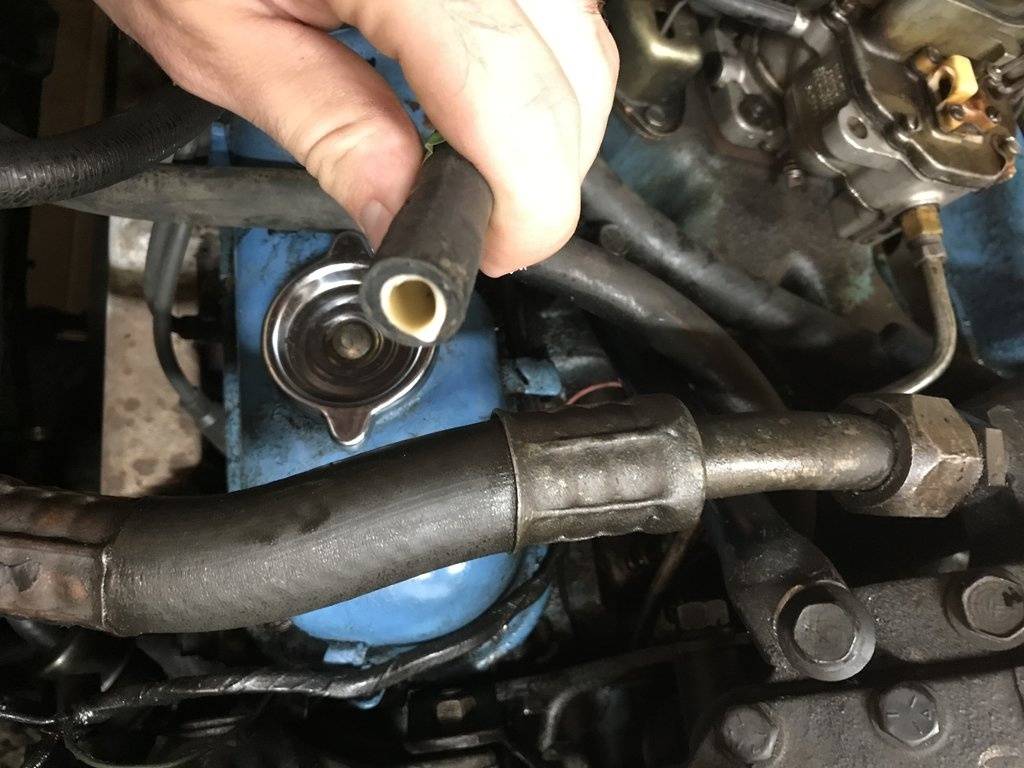

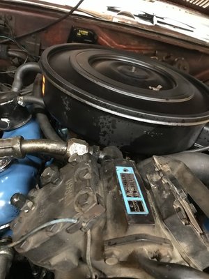

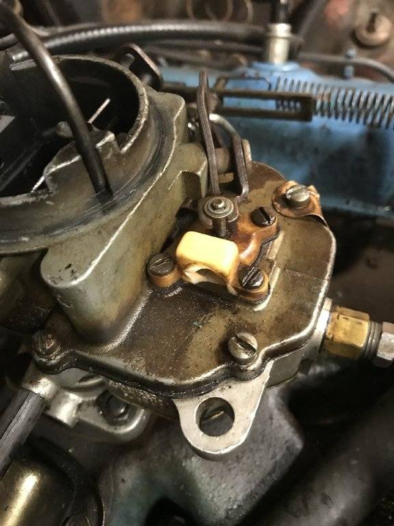

Okay so this has happened 4 times now since I've got the motor running and cannot figure out why it's doing it. I check after every drive and 4 times there's been oil on my intake, under the air filter, on the hood, and on some hoses. The last time it must have blown out about 3 quarts over 150 miles. I'm thought PCV but that seems clear. Maybe valve cover gaskets? I can't recreate it in the garage to see where it's coming from. Anyone have any suggestions? Maybe I have vacuum lines hooked up wrong?

Dried out valve cover and intake front and rear seals would be a place to start.
I agree with 3 b.. most logical places to start with.
I thought as long as it's clear it would be fine. I can blow air through it with no resistance. The hose for it should go to the back of the carb right?
Does the valve rattle? Vacuum lifts it off its seat. Nothing should pass from the carb side when upright and disconnected.
Carb connection location would depend on the carb. If that location worked 10 years ago it should still work today.

While you're waiting for the new PCV valve I suggest you pull the existing PCV valve out of it's grommet (with engine running and vacuum hose connected from carb to PCV valve) and make sure air is being sucked through it. You'd also want to make sure the breather on the other valve cover isn't plugged.

If the crankcase is developing that much pressure your aircleaner should be getting drenched with oil. Closed crankcase system pull air from the air cleaner into the filter eliminate on the valve cover ( black thing behind the oil fill cap) when the pcv valve opens gasses are sucked from the crankcase and internal engine gasses are then burnt in normal combustion.
Never seen a breather cap with all that plumbing. We may need the year and model to proceed.
1971 Plymouth SSP. I think the 3 outlet oil breather was for 71 only. Air filter itself is not drenched with oil which is why I didn't think pcv at first

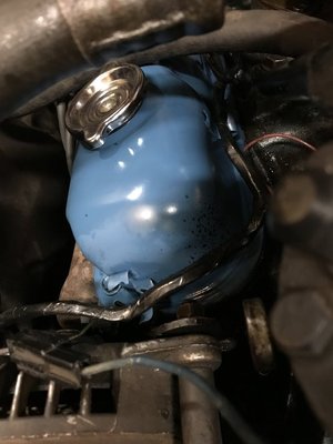

Could this hose be my oil leak? Seems to be spraying out of there or very close to
