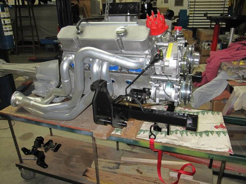

TTI 2" into 2 1/8" on my 65 But, I had to dimple a couple spots where the tubes contacted the main cap cross bolts. I used a large arbor press with steel ball to carefully "dent" the tubes.
Mike
