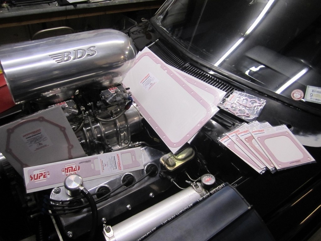

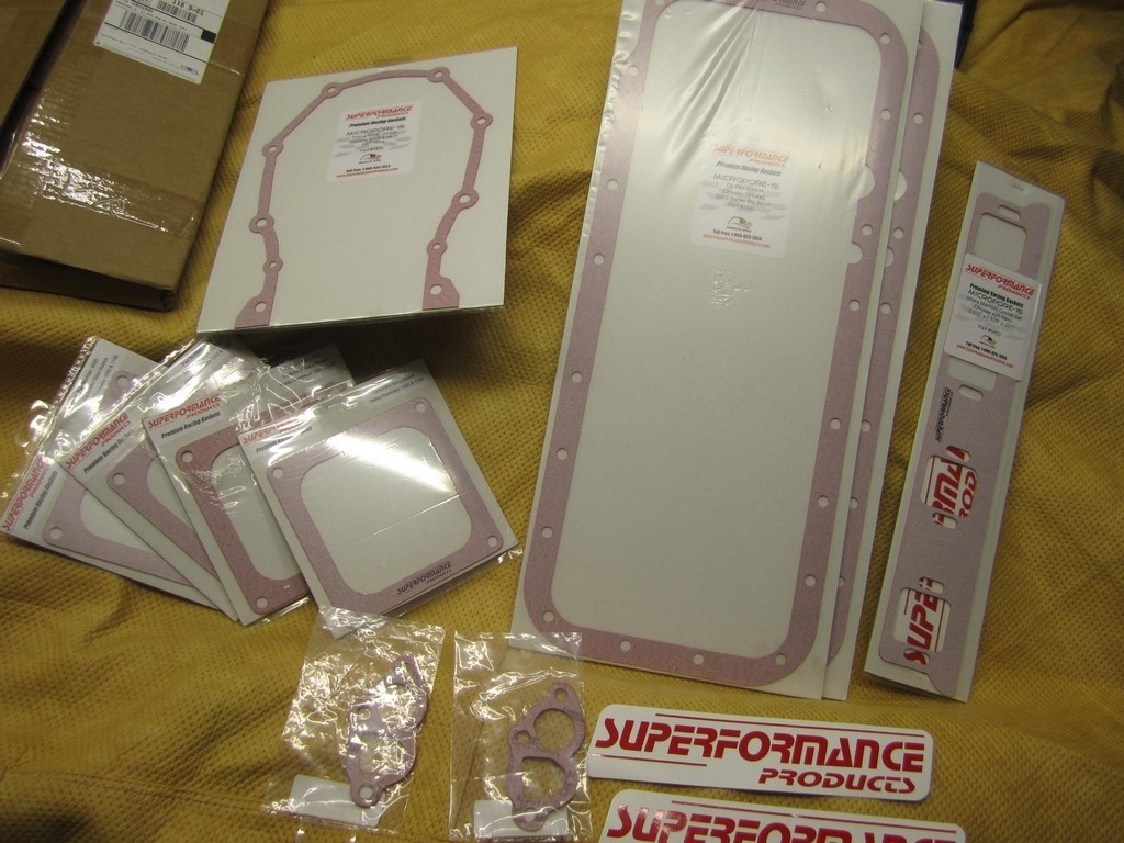

Since my engine build, I've been fighting an oil leak. Was thinking rear main seal, when I finally put the car on a lift I wasn't able to see oil coming from the crank area. Appeared to be from the rear of the oil pan. Resealed it with another set of cork gaskets, still leaking but about 50% less. Now I'm looking at either doing it again but am torn between the 1 piece windage tray / gaskets from summit or picking up 2 gaskets from Superformance. Anyone got advise on which would be the better route? Yes I am using a windage tray.

Superformance gaskets all the way, no leaks just use some gaskacinch on the rails and a dab of silicone at the parting joints. Ive been doing this and no leaks. His gaskets are the best when it comes to oil pans, and intakes quality stuff
So you still brush the goo on when using his gaskets? I thought those were a dry install other than the parting lines.

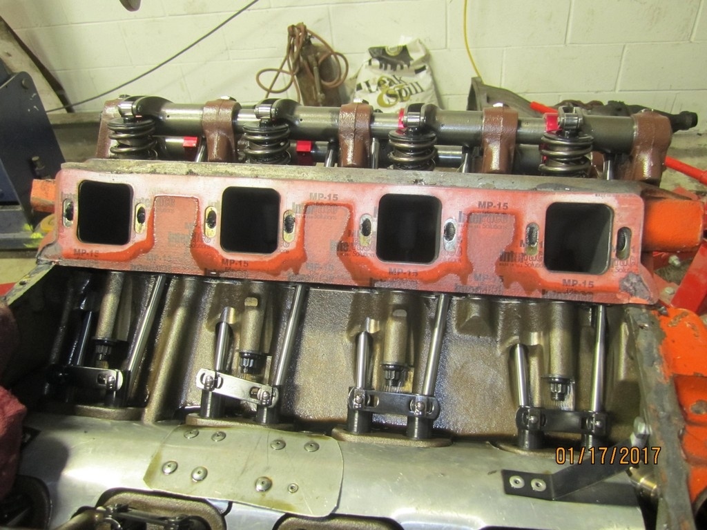

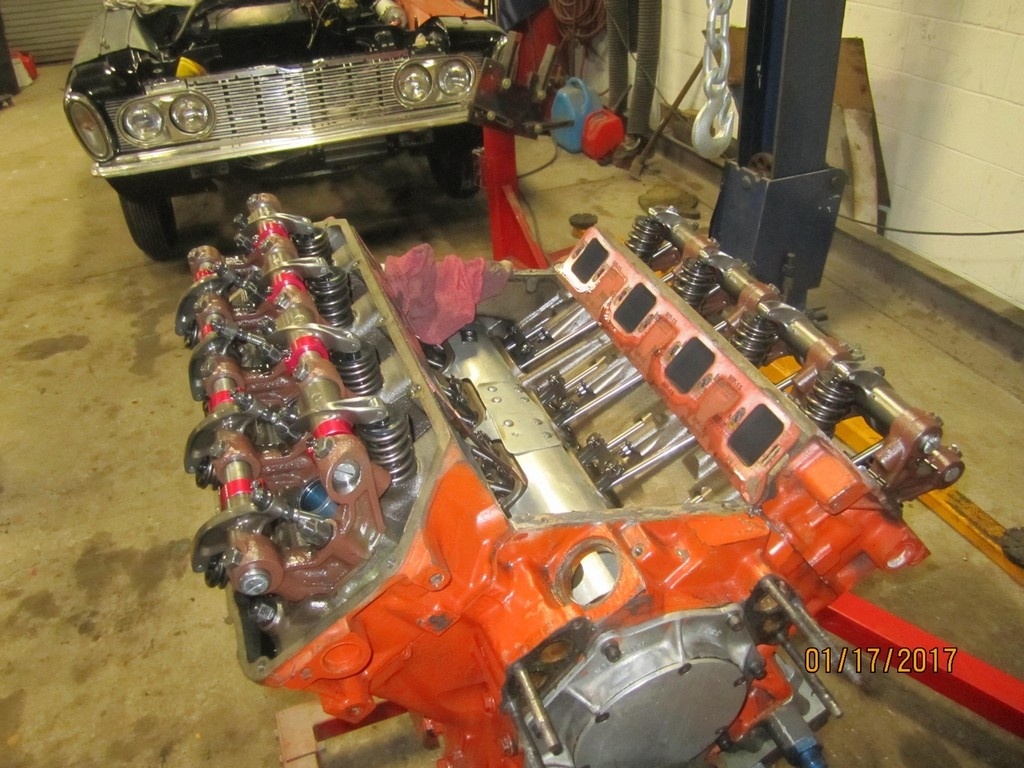

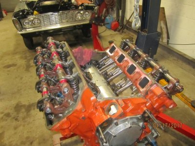

Absolutely no oil coming from top end. I even pulled intake Just to be sure. I've been around the entire engine with a mirror several times.
