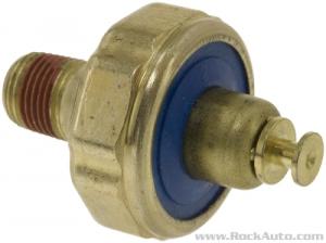

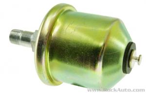

Does your look like any of these?
There are 2 types
The First pic: Fatter unit
The Second pic: Smaller

You are trying to install it on passenger side of block? If you have the large can as shown above mine fits fine with no extensions.

I have the fatter type sender. Just checked it against an old OE sender I kept for some reason and its the same diameter. I am mounting it on the passenger side and it doesn't clear the block, so I went to Lowes and got a pipe extension that should raise it enough to clear the block. Shall try to install it again tomorrow. Just strange it doesn't clear the block as it sits now.....

and as for the oil pressure sending unit, there's one for gauge (the fat one) and one for a dummy light, they both should have no issues with hitting anything :dontknow:
yes, all the senders mount on the drivers side oil hole..there are 2 back there..the passenger side is not used in a stock application
How the hell do you get the big can type on or off, it's impossible to get a wrench in there as we find on my friends car

You need an OIL SENDER UNIT SOCKET, 1-1/16"
I'm trying to replace mine with a digital sender, I tried using a 9/16 crow foot wrench,not enough room for wrench to turn? Any options
I was able to remove by bending bell part off, then 9/16 stud exposed, used deep socket to remove. New digital unit takes a 11/16. Used a crow foot, I real PIA. Easier to do with engine out of car!!!!!
Hey, Mark, the guys are right. The bell type sender is usually on the driver's side. Just swap out the plug, from the opposite side. It's close, but should slip right in. I've always used a short open end wrench, to tighten them down.
