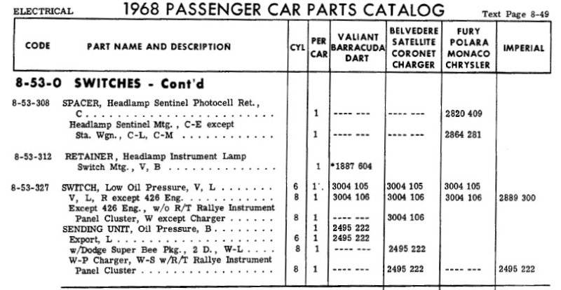

Looking for the part number for the Oil Pressure Sending Unit for my 68 Charger. Pressure reading unit.
I have a parts manual, and usually I am pretty good at finding things in there....but having trouble locating the part number, or a diagram with the part numbered on it.
Anyone have the reference/section/diagram number for the parts manual?
Thanks in Advance
Macdon221
If you need the sender for a gauge, there's only one listed 2495222. If you need a switch for an idiot light, there are three versions and you'll have to choose per your application.
