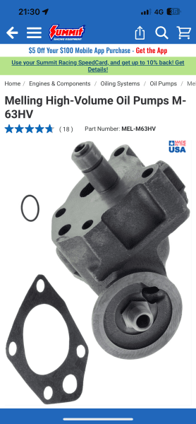

Sounds like that is the Melling M-63HP (or M-63 with the black "Hemi" spring, which is the same thing) oil pump. Those are the numbers you would get. The book says that's fine. But some people can't stand 18psi hot idling. If you want more you can go to 50w oil or put a Melling M-63HV (the long rotor oil pump) on it and run whatever oil you want.

I'm surprised. I figured the high volume pump would have given you more at hot idle. So that being the case it tells you which way to go. Put in the 50w and see how it does. I'm doing a build that I will fire up next week using the HV pump. I'll see what I get for a hot idle. My M-63HP had low 20's idling hot but I'm idling a little higher than you.

He's a little concerned and would like a little more hot idling oil pressure. No big deal, a lot of people are like that. It won't go up at cold idle with thicker oil because the M-63HV bypasses at around 75 psi. That's why he has 70-80 now.
