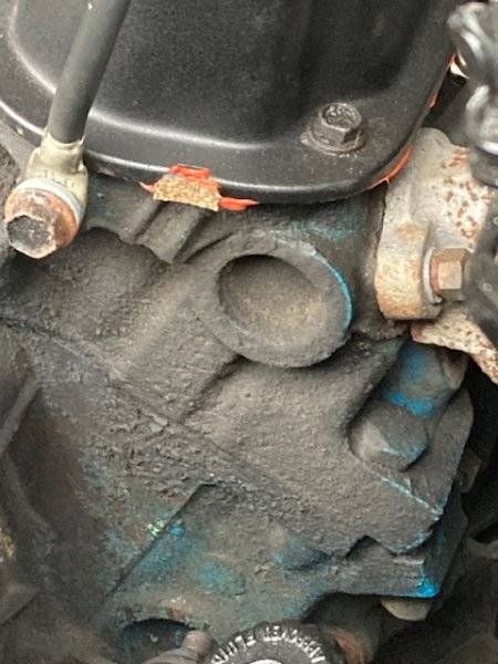

ok, i am adding pics...
here is the oil puddle, i don't think its coming out of the valve covers as there is no oil puddle in the valley between the valve cover and the intake.
Looks like a torker 340 intake

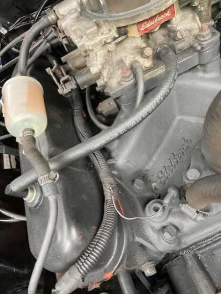

not sure what heads, can you tell from the front? the engine is supposed to be a 360, i am doing some exhaust work soon and can take a pic of the numbers on the block
yes to the PCV, here it is, PCV valve clicks nicely when shaken, not stuck, and a breather on the other side.
