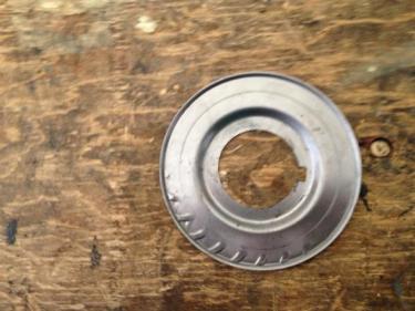

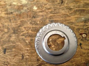

This is what a "Slinger" looks like when it rubs the chain. DAMHIK but this came out of my first Motor on my 66 Ply Sat 383 project...The new Motor is done right so this won't happen again...:angry1:
