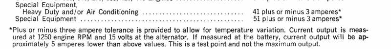

Is that how they're measured now? The old specs (like out of the 1969 field service manual) list the output at lower rpms. For example:
1250 is a lot higher rpm than 650 in drive where is when the problems occur..I don't have a ac solenoid on my Swinger and I can stop the turn signals from blinking at idle with the ac on. I have to slip it in neutral to bring the rpm up. Newer alternators have higher output at idle rpm.
