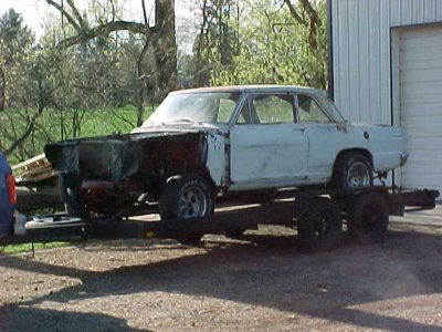

Been really bored lately after selling my rat pickup and needed a project.So my bud had this old gasser sitting in the weeds along with a new glass front,made a deal and drug the old 62 Chevy II home today.Pretty rough from 30 plus years of neglect.

Think on this one i am just going to wing it .Some of the craftmanship on it aint to good in fact down right scary.Today i tore the front axle out as they didnt have the wheel centered in the opening and it looked hidious with the shackles on the rear of the spring.So i am im the process right now of making some decent mounts and should have it back in tomorrow.Need to decide if i will use the glass front and doors or not.If i do use it that will eliminate any street duty so i am leaning toward maybe steel fenders.atleast then a guy could have lights.
Drivetrain?I did pickup up a 4 spd for it.Current rear is a 57 chevy unit but there are some pretty good bolt in options.E body 8.75 and a 70-81 8.5 camaro units have the right spring width and will bolt in with no cutting.From what i am told is the early bronco 9" is the best fit width wise.I do have a couple 9" rears back in the pickers but would need to be narrowed.Lots to think about so for now i am just going to fix the rot and make the car safe and change some previous mistakes.
