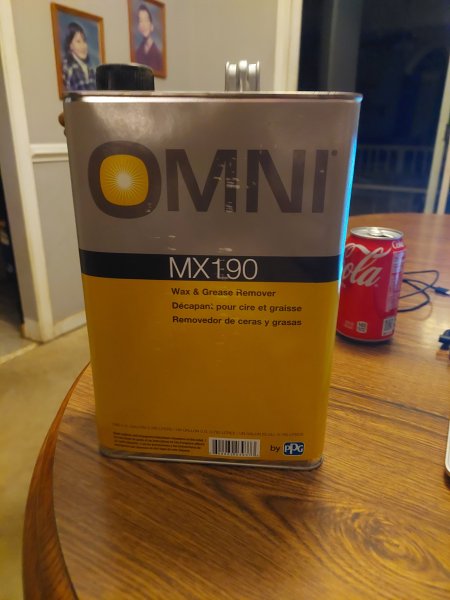

Omni MX190 cleaner/dewaxer anyone using it?

Am I using it right. I sand the car and spray this on the part and wipe off before I prime. .I feel that I can get the same result if not better with Lacquer thinner. Im not a car painter and thats why Im asking. Does lacquer thinner leave a residue,chemical reaction? Just not impressed with the omni cleaner. thanks Dave
I just dont want to get it primed and have problems.

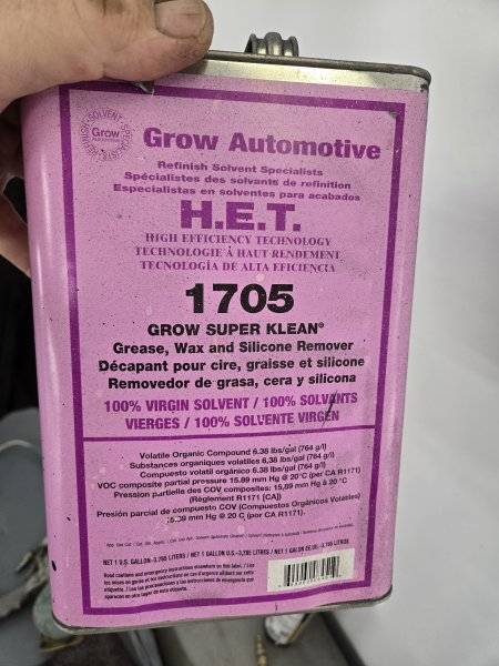

I did find a lower cost product at NAPA that works as both. Made by G.R.O.W. I use it on day to day stuff.
