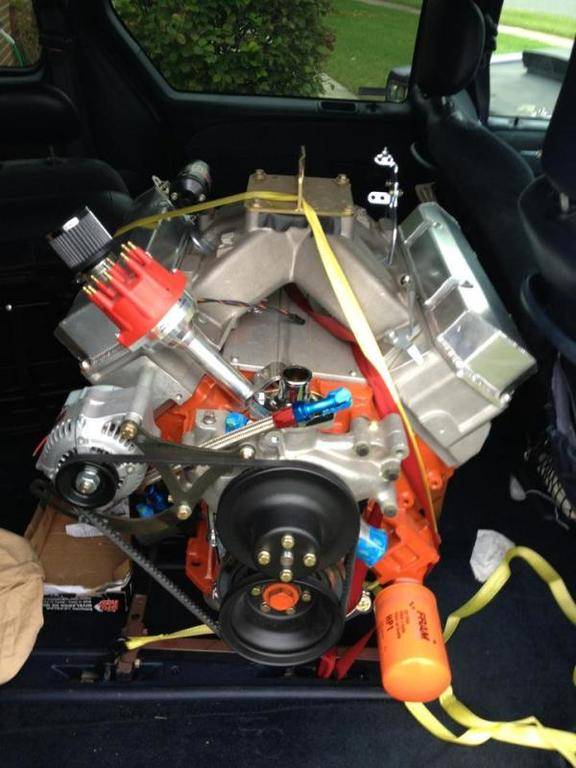

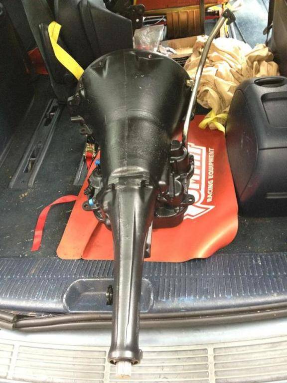

Picked up my new engine and trans last night. Just a little street 498 :)
Thanks, it's alittle over kill. But luckily it has a very mild hyd cam but still made over 600hp/tq. I'll post the details later.
A little 498 ! Mine is only a 493 and ours a small strokers by todays standards. It looks great and I use a Dynamic converter also. Very nice. Ron
Real nice 69!! Hope you have a lot of fun with your new 498..
LMAO love the placement of it hehe, on the backseat
Haha I know, This was the 3rd engine we have stuck in the van surprisingly they slide right in but one of these days I need to get a truck. Lol
Thanks Ron, yea not a big fan of 60 over but it's a 66' block so I figured it was thick enough. it's amazing that nearly 500ci is small but with these 600+ mega blocks I can see why.
very cool, very nice, looks like LOTS O' FUN.....
Oh it does, I can't wait to get that thing running. Just gotta decide on a carb, headers, converter and driveshaft. Then that beast will be tearing up the streets.
