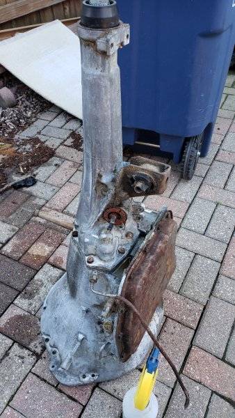

Ha! No, but it looks like it leaked and was operated in a dusty dirty environment and everything stuck to it!

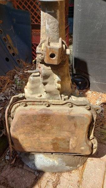

Not sure what makes it a truck mount, but it's a car ext housingHere's the truck rear mount. I see that the tailshaft does have the holes for the shifter linkage!View attachment 1846326
It doesn't have a vin stamp and for those of you that don't like looking at "Dirty Pictures",
I just went out and squirted it with Purple Power!!!!
I think the mid 70s to late 70s transmissions and rear mounts were basically the same. I removed a 727 from a van once it looked just like that one, although I don't remember if it had the floor shifter linkage bosses on it. Later in the 70s or early in the 80s the truck tailhousing changed with extra strengthening ribs and the moving the little plate that covers the big snap ring to the side instead of the bottom. It really does not matter what it is if not using it for restoration. Build it and run it.Here's the truck rear mount. I see that the tailshaft does have the holes for the shifter linkage!View attachment 1846326
