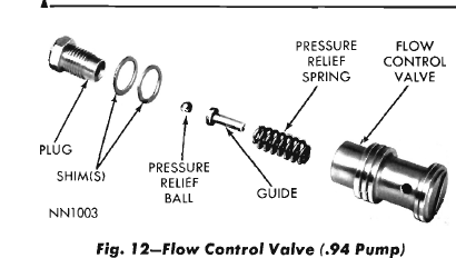

Hi, Never having rebuilt one of these before, I bought a kit and disassembled the unit. It was leaking from the main body seal. That seal was rock hard and square. Also found other seals needed replacing. It had a good clean and I reassembled it. Only problem is, I disassembled the pressure relief valve (followed a youtube - that was really bad). The guy pulled the pump apart, cleaned the relief valve and screwed it back together. I cleaned it out and then screwed it up, not realising that it was a 'factory set'. How do I reset it? Just go half way?
On a separate issue, the flow control valve was very tight in its bore. I had to lightly tap it out with a small drift. Is that normal?
My pump looks idential to the one in the pic below.
Cheers.

Thanks, but that's the video that led me astray. The guy pulls out the pressure relief valve, unscrews it and just screws it back together, hand tight. The calibration of the relief valve is lost. Apparently they are factory set. It looks like it was hand tight, which gives me a rough lead. Probably needed to be fitted with loctite too, if it's only hand tight.

That valve is preset from the factory. The adjustment is made when the valve is made. It is adjustable but not recognized in the factory manuals. Once he has taken it apart without marking it there is no way to know its setting.

Guy in the vid did not know jack ****. Gets an A for effort. You can adjust the Saginaw with shims. His is the .96 pump. All he can do is try it. If there is issues he could take it apart and try adjusting it. The FSM shows pressure and flow test. What ever test fails you throw parts at it, no adjustments. So now at this point a guy has to think out of the box.
