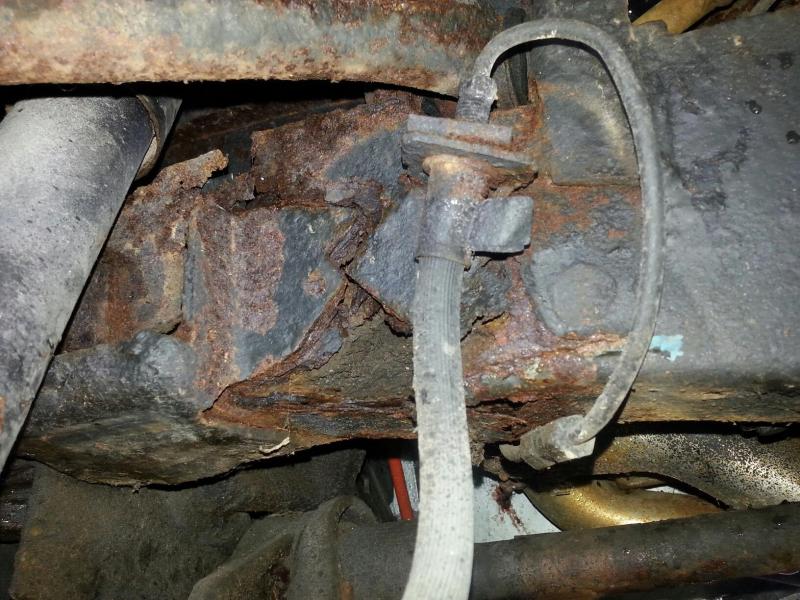

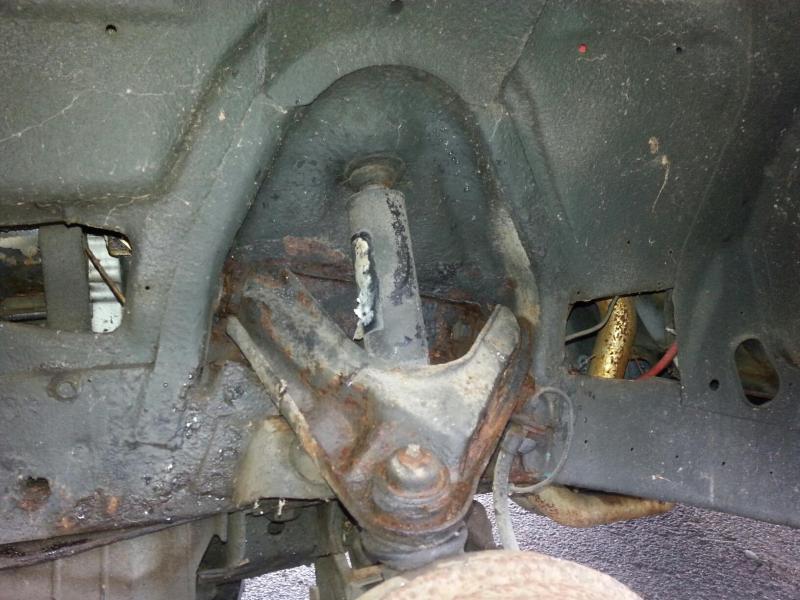

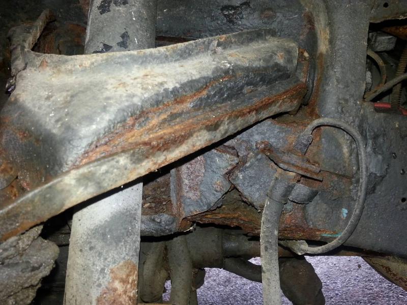

Gentlemen (and ladies). There's a 70 GTX clone for sale on ebay in NY, not too far from me. It looks nice, but the seller did disclose that there were some rust issues. There is some serious rust on the front frame by the control arms, not sure about the rest of the frame.The seller did send me the following pics showing the bad areas. Also, in the listing, it shows the trunk pan needs replacing and also some bubbling in a few spots ( was painted about 10 years ago.) I'm asking for opinions on whether the frame is repairable and estimates on what it would cost, also estimates on the trunk pan (I'm not a body man and can't do it myself). I'm attaching the link and the pics the seller sent me. Thanks.

That is some serious corrosion. Of course it can be fixed, but the fix may involve completely replacing the frame rails.

With the amount of work that might be involved, don't be swayed by the shiny paint. It might all have to come off anyway. I'd add up the dollars that might be needed, and save them for a genuine GTX.

at very minimum you will be doubling down on the asking price to make this a nice clone and that is a conservative number if you have to shop out. 85 plus 85 = 17,000.00 which would buy a pretty nice clone already done. that rust out in the middle below the rear window is a good bet that the corners are shot also. i am with photon on this one.

That car needs a rail or at least a large section. I bet there's more then what you see in the picture. That is a very common spot for them to rot. I've had at least 3 cars with a similar spot there. It is probably the worst part of the frame to work on. If you can't do the work yourself find a better car. It's still sitting there for a reason.It will be expensive. Engine, Trans, K-frame and the rest of the front suspension will need to come out to do it right.

however, that frame is VERY disconcerting, everything above, below, around, on and in will HAVE to come off to do it right. At the very least, the rotted frame rail removed and a new piece spliced in.
