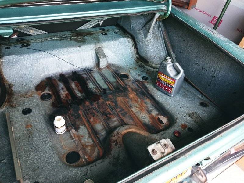

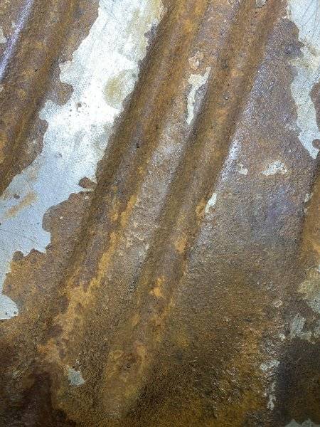

I have surface rust on some parts of the trunk floor, I scraped off what I could and then used a wire wheel. I am wondering if there is another step I can do work away at it? Or should I just sand down what I can and then put some paint/primer on it? It is in the trunk so it doesn’t have to be pretty, I would just like it to last. See photos below.

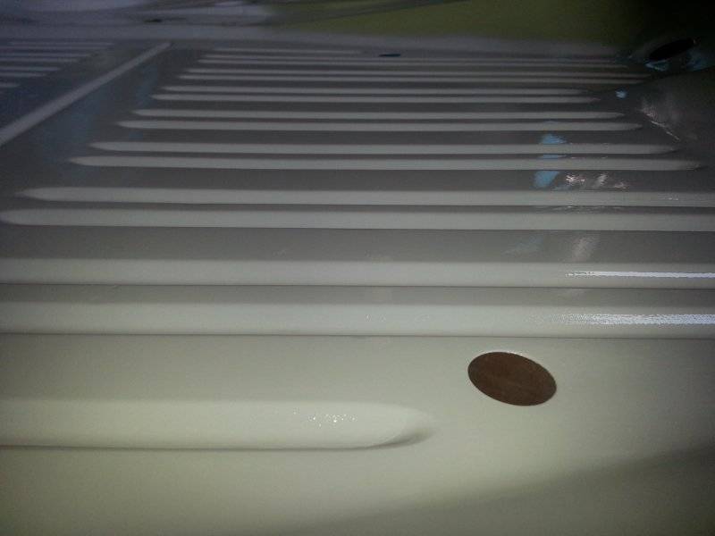

I did what you did, then I poured some Evaporust into the channels, and kept clean rags, dampened with the solution over the surface areas, and let it sit several days, and cleaned it up. When it warms up, probably next spring, I'll rebrush it again, and prime/paint it.

I use Corroseal on my rust then paint over it... it stops/seals the rust up and works fast, brush on..

I’d go with evaposrust or acid. Your trunk is in pretty good shape it will clean up easily. Wait for the warm weather though. Then it will dry fast.

The only way to make rust go away forever is to take it to bare metal by blasting it off. Everything else is just covering it up. How long the rust remains encapsulated depends on how much moisture it encounters and how good the products are that you use.
This looks like the kind of project that is the latter. Wire wheel as much of the rust off as practical, apply a good rust converter product, sand, fill divots, prime, and paint. Forego use of a rubber trunk mat or use something that breaths and make sure your trunk seal is good.
