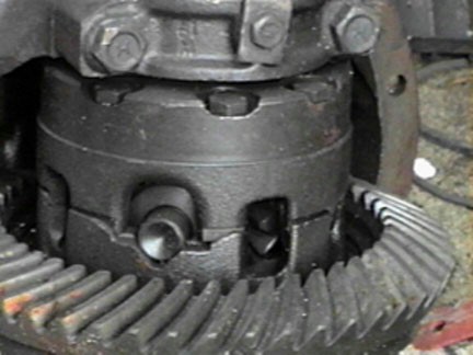

This is a picture of one i found and its the same as the one in mine .. It said on the picture that it is a sure grip (clutch type "power lok") differential
then it says (this is the one to buy!)

Lots of folks are partial to the 742 (clutch) type of sure grip unit saying the cone type can't be rebuilt. Cone style can be rebuilt but it takes a bit more effort because machining is involved. Check your pinion spacer, is it a spacer and shims or is it a crush sleeve? If you are going to drive a car hard with the 489 case set-up you are best to use a spacer and shims. Crush sleeve can continue to "crush" under severe loading, such as drag strip launches, alowing the pinion to "climb" the ring gear. This can lead to binding and breaking teeth off of both gears. I saw this happen with both a 9" Ford and a 489 case Chrysler with the crush sleeves.
