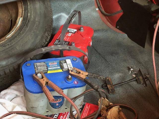

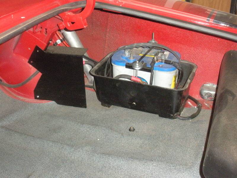

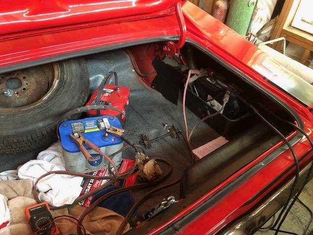

I had a blue top for years, it finally went bad after the car sat and I couldn't bring it back. I bought a yellow top, (blue is just a yellow top with marine terminals now - they're not the same 'storage' battery they used to be) and the yellow top wouldn't keep a charge over 12 volts. I've basically had 8 Optima batteries in five years in three different vehicles, the only one still going strong is the one in my Toyota pickup (the third Optima in that truck over the past few years). It will get an Odyssey when the Optima fails again.It is a bit crowded in there with all this going on.
The Red Top is about 3 years old, the Blue one might be 7 or 8.

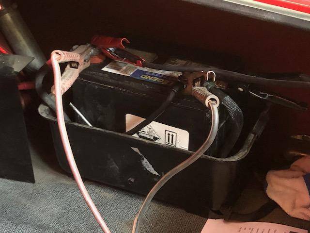

This one is just a regular one from the NAPA store.
The old Blue Tops were great for that.. they were Boat/RV batteries and I used one in the Plymouth for years. When it finally died, I replaced it with a Yellow because Optima told me that they no longer make the "blue top" as we knew it, it was just a Yellow with Marine terminals. The yellow failed on me and I replaced it, then that failed and I was told I didn't have a warranty anymore because it was a replacement. After I tried charging it and it nearly blew up, that's when I turned to Odyssey.I have had good luck with NAPA brand batteries for my daily drivers. I just thought with the extended times the old Dodge sits, I needed something that holds a charge a LONG time. I may have been wrong about using an Optima though.
With any AGM battery, to get it to hold a charge you gotta use a wet cell battery in line. So, connect the 2 positives together and the 2 negatives, now hook your charger to the wet cell battery.
I had to do this to bring a Red Top back from the dead and it worked great.
