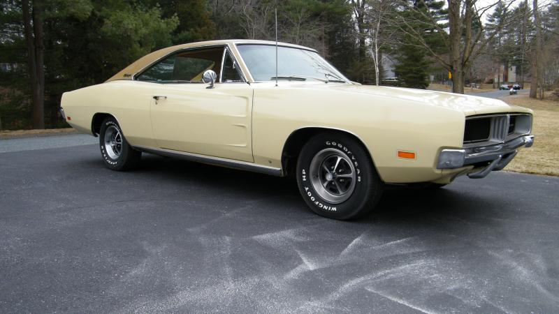

I'd like to see pics of your Charger. I had a 73 long ago. Also 16?
There's one.......

Niiice. A few miles away from my house, a guy has a 69 he's working on to go with his Southern Culture museum. He's at the primer stage
Many here will say that I have no culture, which may be true, but I have plenty of character.
