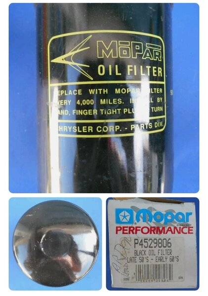

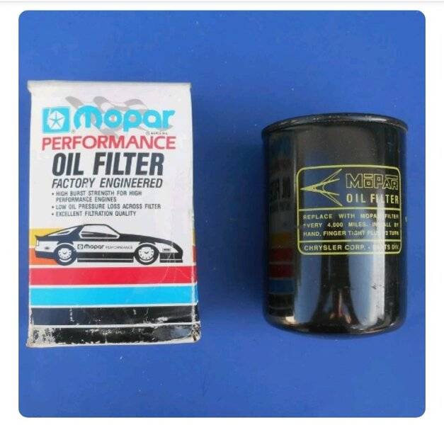

I see some Mopar brand oil filters being sold online for the early cars. Anyone know which filter number would be correct for a 62’ 361 B motor? My TM shows - of all things, a Perolator PER-1…

Lots of cars use the PER-1 and PH8A FRAM. Mopars, Fords and even 6 cylinder Toyotas! I think the older filters were black and I think somebody supplies a repo.
I get the black 'mopar' filters at the auto store that are likely the same as any just having a different label; I have to use the shorter filter since I have headers on my '63. Oil/filter gets changed about every 1000 miles.
