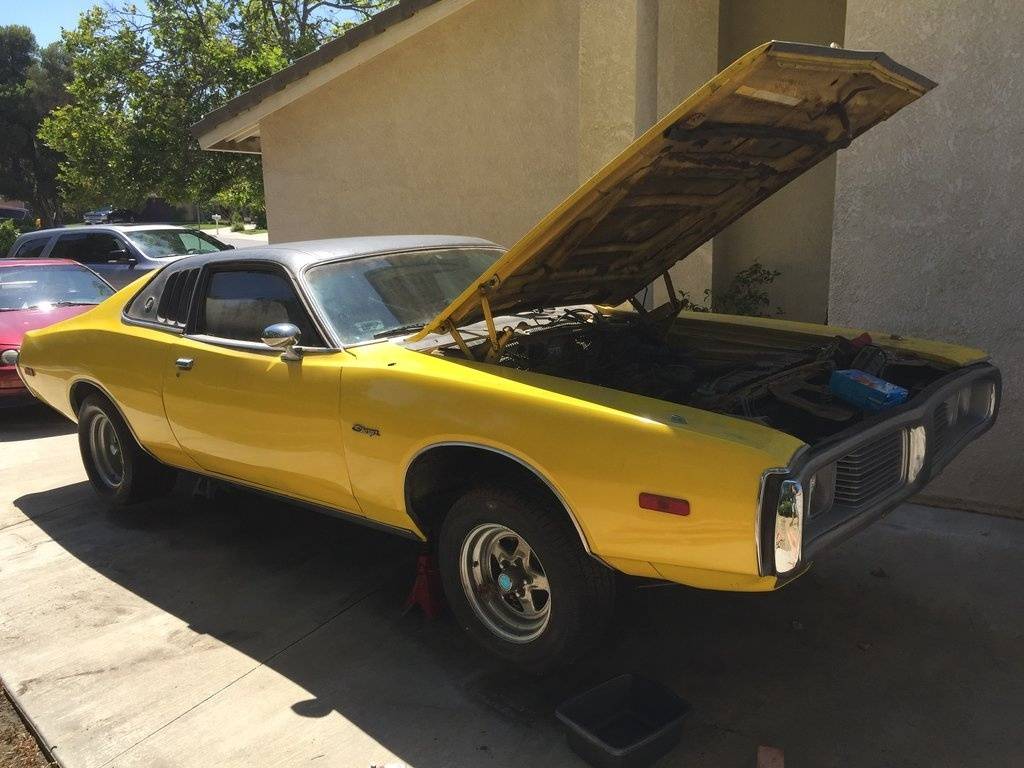

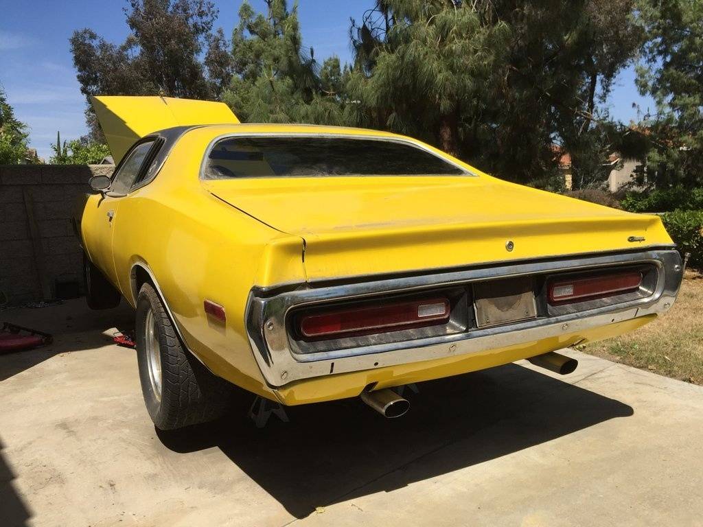

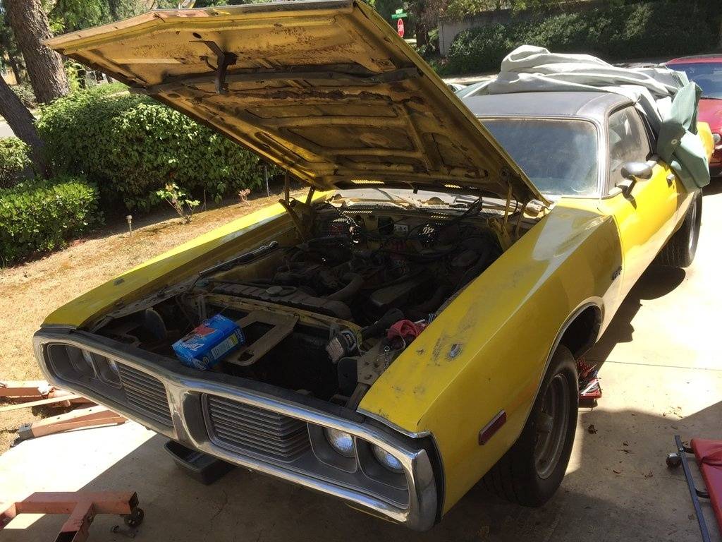

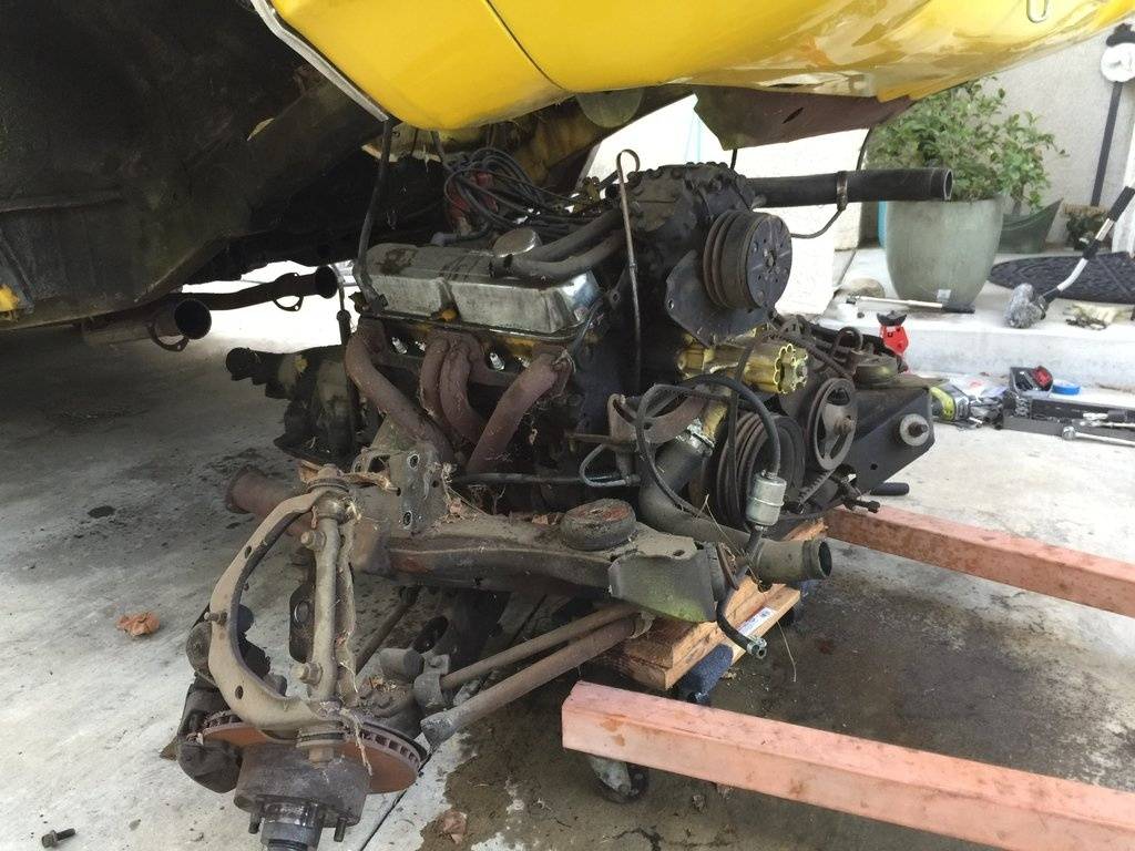

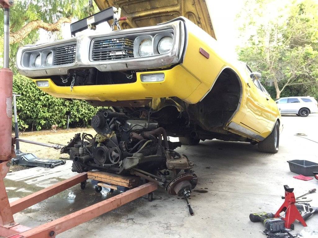

Want to share my build and give a quick background story. My dad is the original owner who bought it a few weeks I was born. He is now 80yrs old but still living strong. This was my first car when I turned 16 and loved cruising through the high school parking lot turning head back then. It was the car that I took my wife for our first date. Since then I passed it on to my younger brother to carry the torch. He and I eventually moved on to modding import cars for track road course but now have circled back to give the charger the needed attention after sitting for years and rusting away. Here is me back in the day.

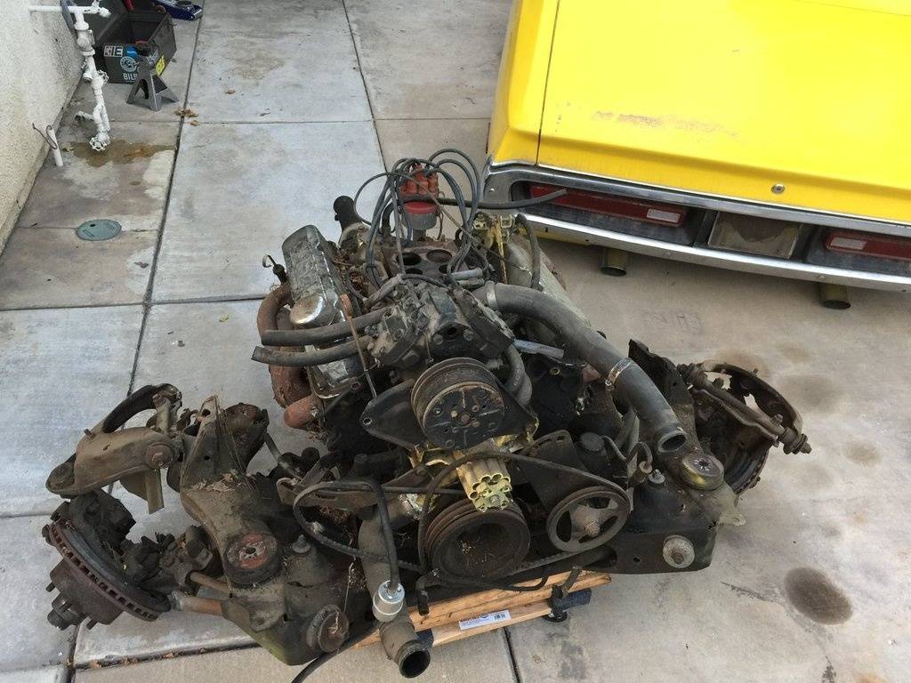

It has the 318cid w/904 auto and bench seats. I did rebuild the engine long ago w/ .30 overbore, mild cams, hooker headers with magnaflow exhaust. It sounded great back then but now it's going under the knife to get a new heart.

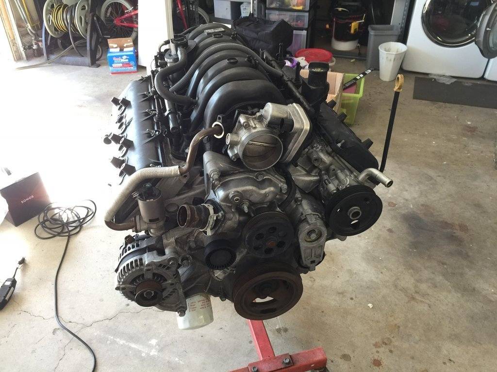

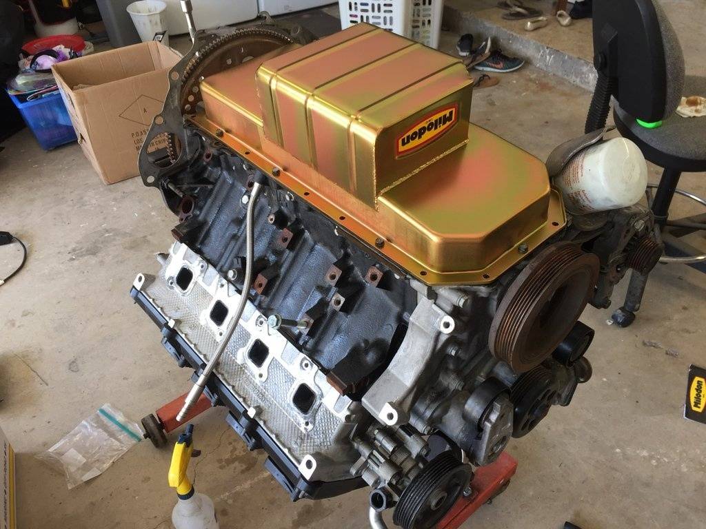

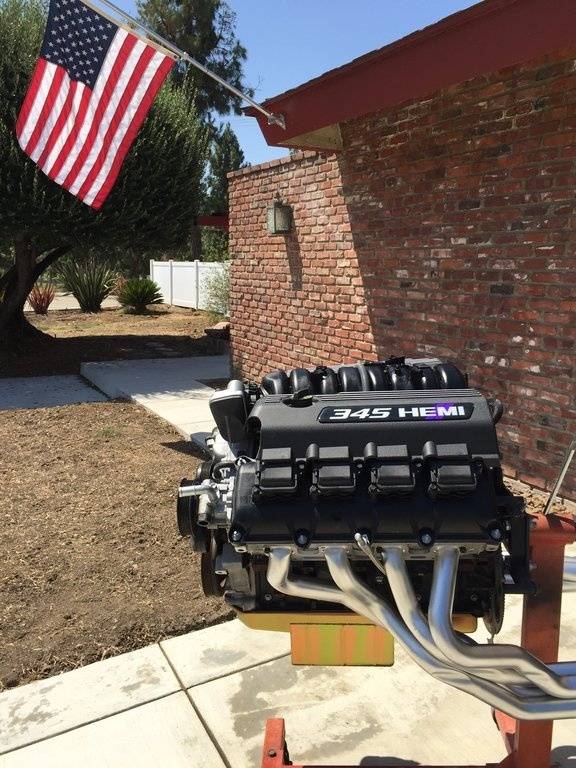

Here is the new heart that's going in....
More parts coming in so stay tuned..... 01c6e828617fe43e59af67afd0c6f6c6d219e49597.jpg 01687f796826d973bc31e482e9d07288652f4d1a9a.jpg

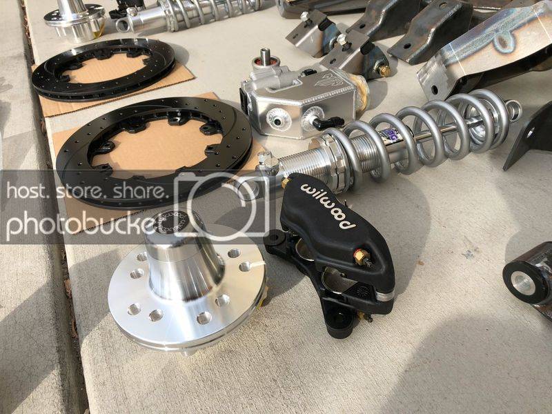

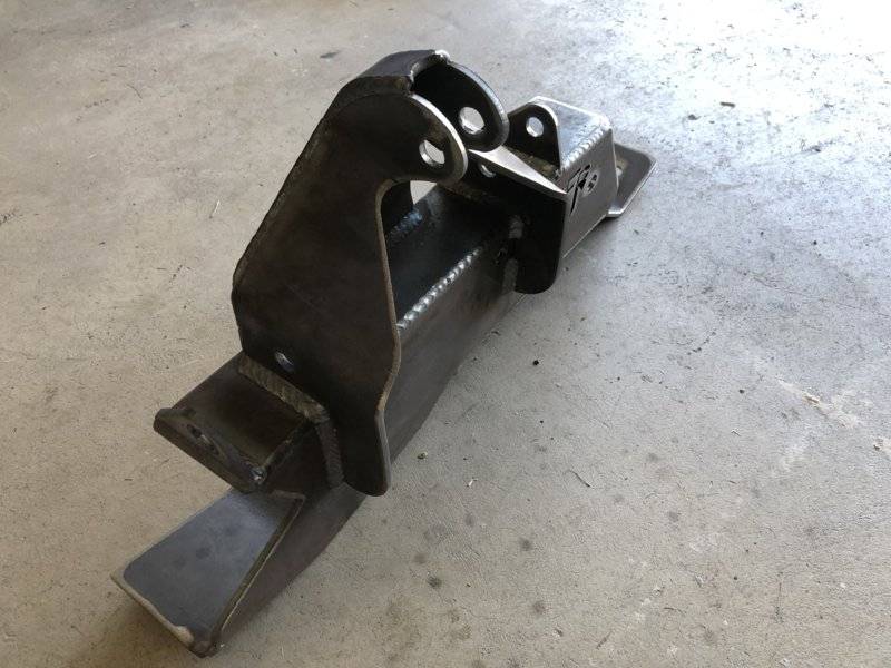

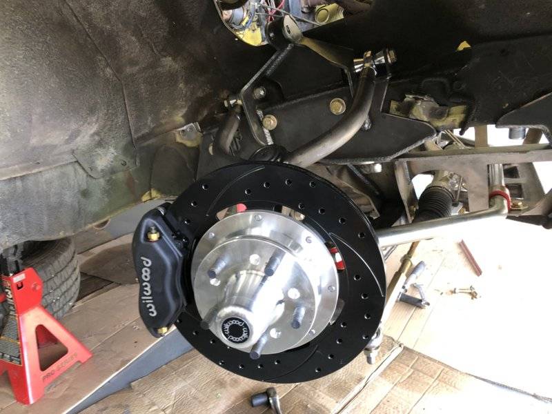

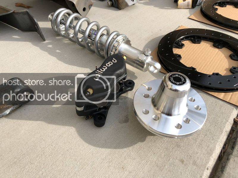

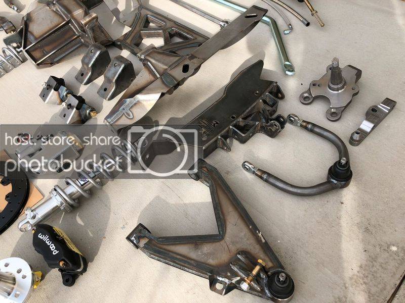

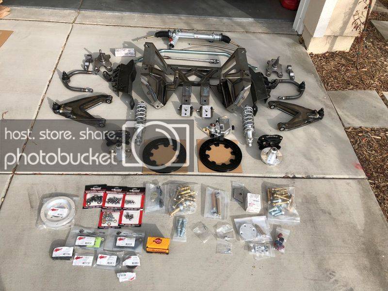

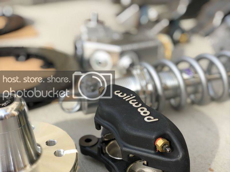

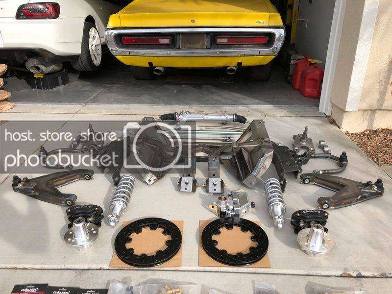

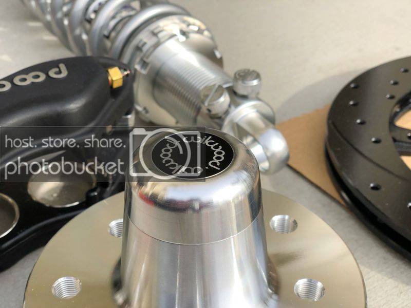

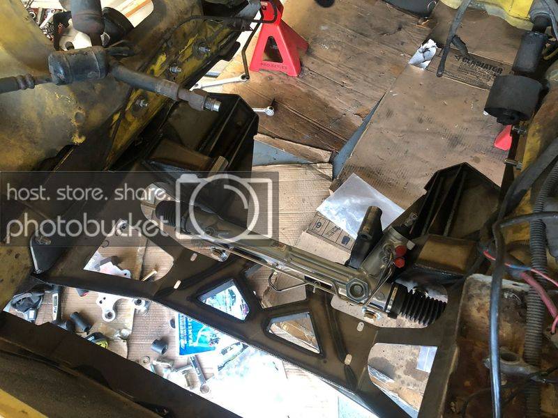

Anyways, back to the real American fun! Over a year ago we ordered the Magnumforce suspension kit and it took a long while to get built and shipped. Seems like they just build to order. The kit is very well made and quality welds. I opted for un-powder coated as we want to customize the finish. Not sure what color yet! The Viking coilovers and Wilwood brakes are very sexy!

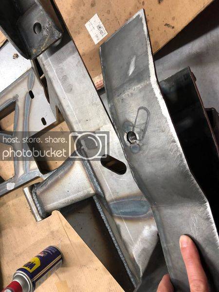

When we got the kit we wanted to test fit everything before we powder coated in K-member. This kit does require you to drill out the subframe to insert your bolt sleeve and bolt to secure the frame rails. The bolt sleeve needs to be welded in which I'll get to later. We drilled the holes and mounted the frame rails which also also has the upper control arm mounts. When test fitting a lot of the mounting points didn't align which required me to send back some parts for MF to fix and remake which they did and sent other updated parts without problems.

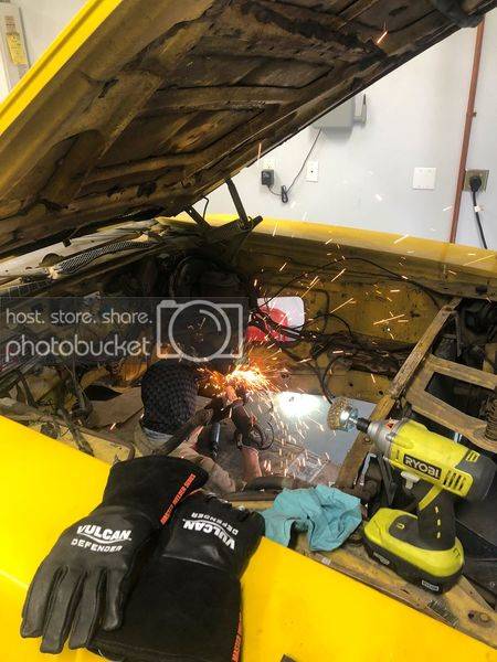

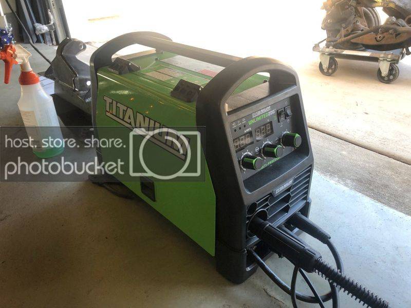

After getting the parts back, things were looking good! However welding in the sleeves created a delay as I don't know how to weld and was waiting for a coworker to help weld them in. After almost a year of delays and schedule conflict with my coworker, I decided to man-up and buy a welder to do it myself! lol!

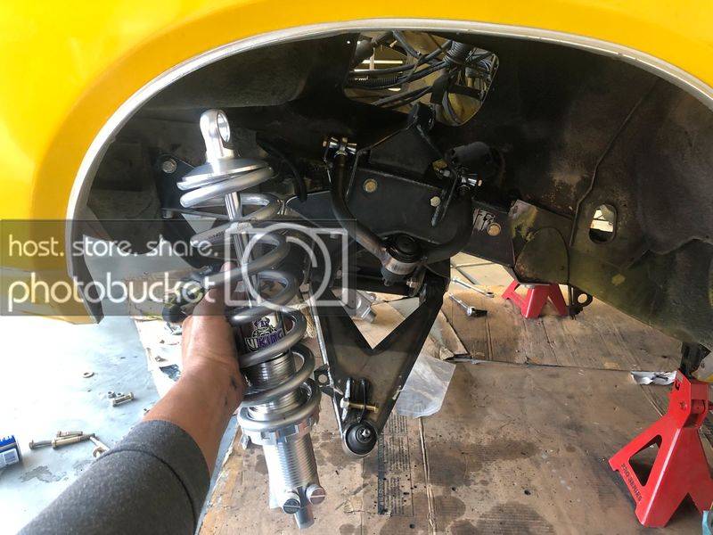

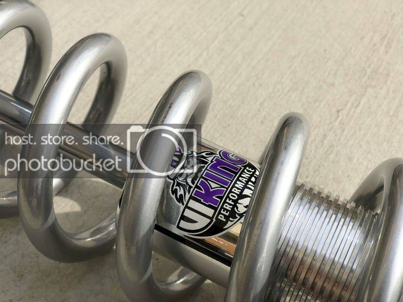

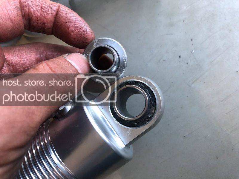

Once we got the K-member bolted in things we're smooth sailing till we hit another snag! When we were installing the Viking coilovers, the bolt inserts they gave us were the wrong size!
These coilovers were shipped directly from Viking so they sent the wrong size inserts. I had MF work with Viking to send us new inserts which I just received. That's where we're at! Need to make time to finish the test fit!
Once we finish test fitting the suspension, we need to drop in the engine and trans to see what modifications we need to do for the trans tunnel as we need to cut and enlarge! more fun stuff to come!

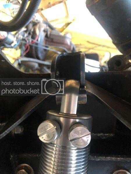

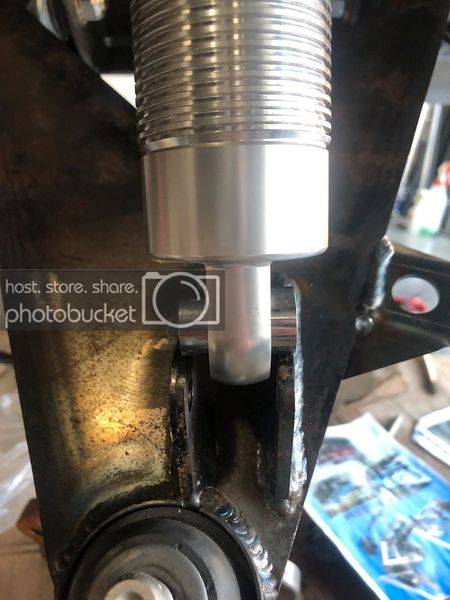

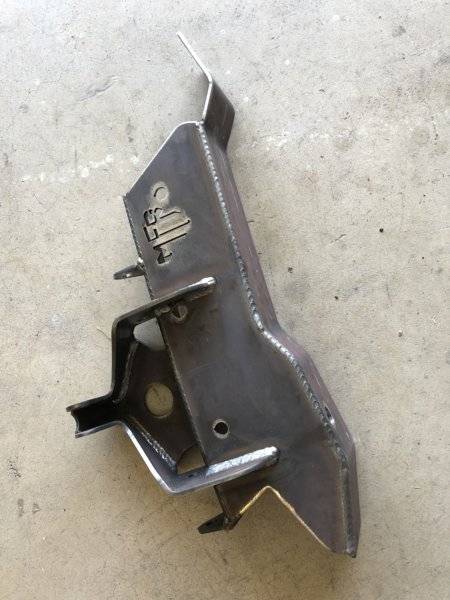

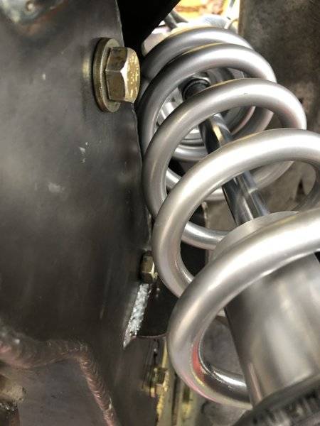

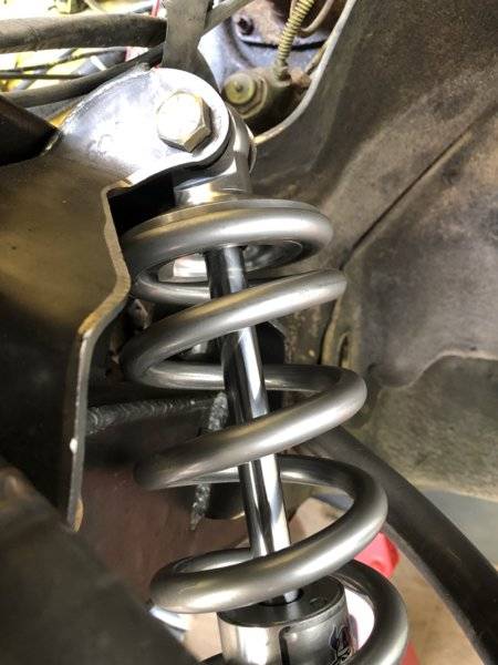

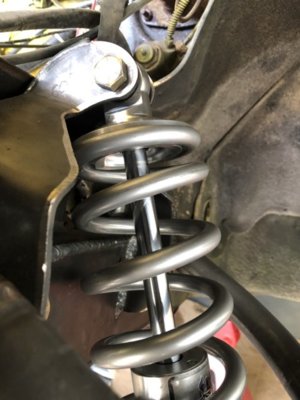

A quick update. We hit another snag with the magnum force upper control arm mounts. The shock mount geometry allows the coil overs to hit the frame. Had MF remake the upper mount and need to install.
