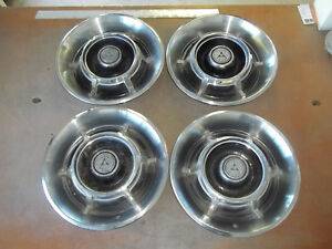

These are 67 hubcaps but sure do look like whats on that car..... I think some were used into 68 as well.
Interesting! I guess the plant had not received the ‘68 covers yet since it had just started building the Charger. Is that cover available in 15”? I like it!
