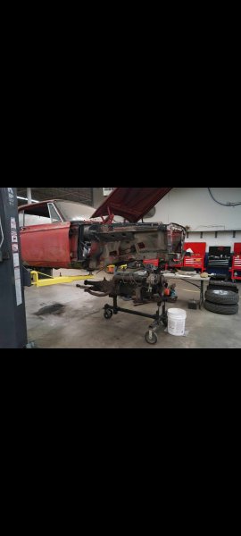

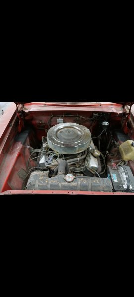

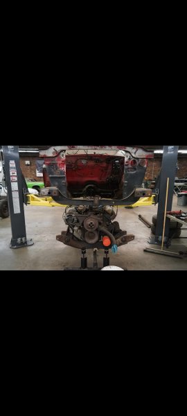

Hi Everyone! New to the forum and excited to connect with fellow Mopar enthusiasts. My dad Roland and I bought a '65 Satelite several years back at Chrysler at Carlisle and currently the project is underway to restoring it as it had rust issues. When dad passed away I was left to finish the project but couldn't remember what engine was in it. Can anyone give me an idea? The shop said it's a 429, but that's a Ford engine and not sure why they would think that. I think it's a 361 BB? Thanks for your help.

or Take an even a better photo of the front/top of engine
maybe turn your phone 90*s for a wider photo
get a better & closer shot
It is a BB, the distributor is in the front (a SBM will have the dist. in the rear)
from the photo can't tell which BB,
it could be a 426 RB wedge,
or more than likely a low-deck B-series either a 383 B wedge or 361 B wedge
it looks to have a 22" wide radiator too
that are usually associated with the smaller 361 & 383 B engines too
all 3 engines were offered in 1965
it looks too narrow to be a 426 wedge, can't tell for sure
the 426 RB (any RB does) also have a lil' cast-in pad/ID
(the B-series low deck doesn't have that ID pad)
on the right front of the engine block, just in front of the intake manifold/valley pan
but hard to tell by the crapy photo
