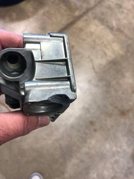

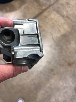

Even with the Promax base plate, you still need to grind the float bowl for the screw driver access.

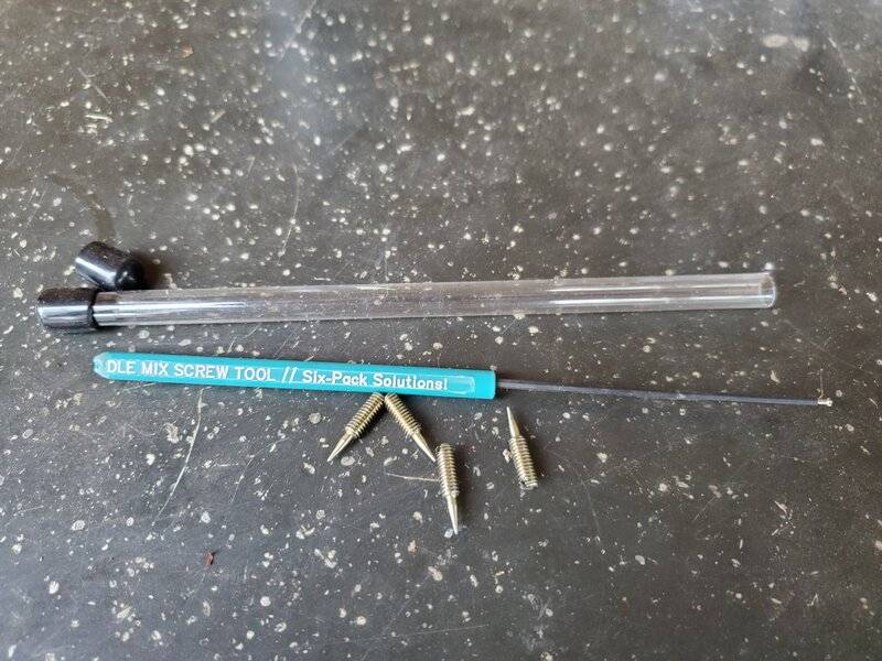

This works great, replace the idle screws with Allen head type and adjust no problem.
Bought the kit from a fbbo member many years ago, very inexpensive.
Don't need expensive base plates or carb swapping ( swapping front to back is close and has been done forever, but this is a bit more accurate imo).
