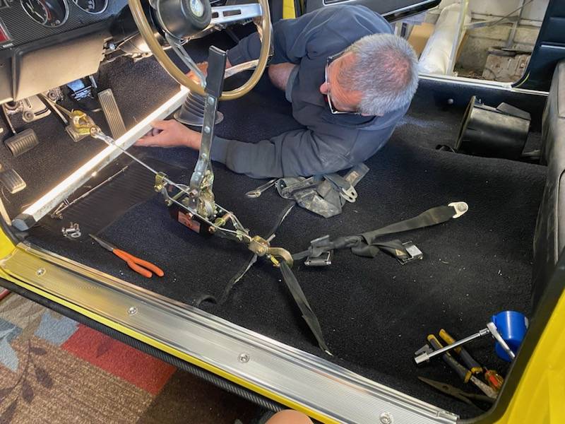

the spring is out of the car i managed to slip it back in. ill post pics of my Mcguyverism
LOL well the washer trick wont work in this situation or this year of pedal assy. just getting the spring and pin in place i had to use superior mopar cunning. - and I wasn't going to loosen the pedal assy the cars all put together - so you all can see what i did- it worked great spring stretched a half inch and presto!!!!
