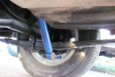

I have installed Add-A-Leaf springs to the leaf spring pack with much success. I don't recall the part number but I can check when I get home. Basically, remove the axle U-bolts and then the centering bolt that holds the leaves together. You insert the Add-A-Leaf 'leaf' (spring) into the spring pack and then reassemble everything. Raised the rear of my 65 Belvedere by approximately two inches. My 65 Fury is next!

They come in pairs. I got mine from Summit Racing. Pro Comp Add-A-Leaf Kits 13120 (Summit # EXP-13120). They were $36 for the pair.

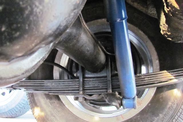

Here are a couple of pics of the helper leaf installed.
I installed the new leaf one place up from the bottom. The bottom leaf is actually a half leaf (factory). I actually drilled a new centering hole so that I could position the leaf properly, for the best fit.

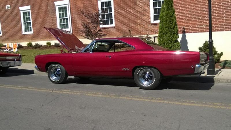

If I recall correctly, an "L60" is the same as a 275/60, correct?
If so, I can tell you that tire fits in the stock '68 GTX wheelwell without need of helper springs.
After all, that's what is on mine. :)
Key is getting the right offset on the rims...
I love that color on your X! I agree with you on the tire fit for the car. The problem is when I had cragar build my wheels I don't think they gave them the right offset causing the problem. I didn't notice it until long after as the car was being built. It's a long story - but at the end of the day I need that extra inch or two to give the lift over the tires. Life would have been a lot simpler if that process was done correctly. There's more to it but it's a two party problem. That why I'm looking again for a solution.

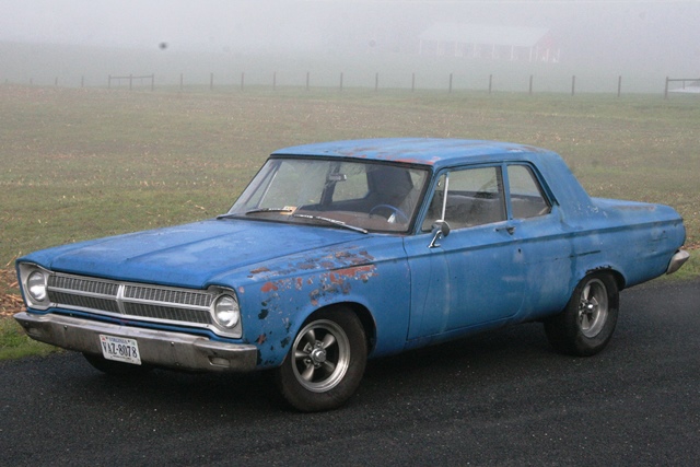

It definitely depends on the rims. I have 15x7 rims (first steel cop wheels, then aluminum mags) with P275-60R15 tires on the Belvedere and they fit like a dream. I want to run the same size tire on a 15x8.5 rim but that will not fit. Need to narrow the rear by about 2 inches.
