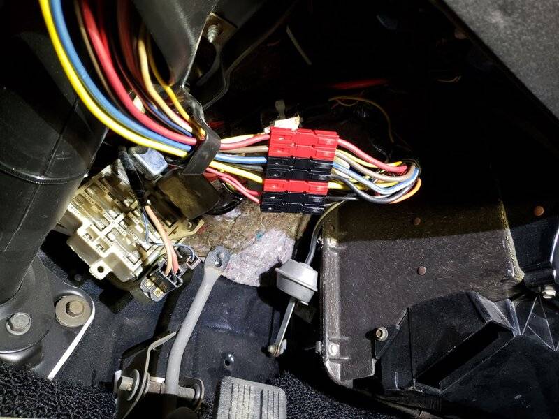

The Molex connectors at the ign switch has been a problem since they where first used in that application. Resistance and heat build up is common at those Molex terminals. I replace those Molex connections, with better quality and correctly current rated Anderson Powerpoles, and or by-pass any other disconnects in the ign1 circuit to get the total voltage drop as low as possible. I will by-pass the ign1 bulkhead connection as well. Another step I’ve taken on some cars is up-sizing the ign1 wiring to the VR to 12ga.
BTW, if you take your drop measurement on each side of the Molex terminals while under full load you can see just what specifically the Molex terminals are contributing to your total number.
