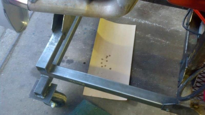

I am fighting the age old problem of a rear main seal leak on my 440. We have had it apart so many times I have lost track. We have tried just about everything without definitive results. Down to just a drop a minute from a gushing leak when we started.
