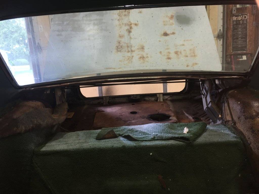

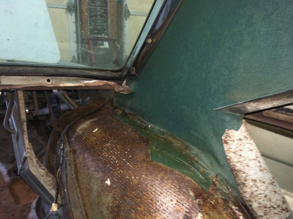

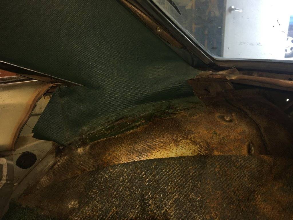

Has anyone ever seen a car where somebody completely cut out the package tray? Any thoughts on what to do or where to find a replacement?
It's a CA car with great metal besides this weird mess.

I don't think Masonite or 1/4" plywood will put strength back in the car. I'm not missing the top cover--the steel was torched out.

it looks like the hacked out the side supports also.

It's a '66 Belvedere 2 door hardtop. I've got a lead on one close to me. Hopefully it works out. We'll see. Bad news: Nobody made repops of 66 or 67 model years. The good news: even the most rotted, rusted POS should still have a good package tray.

Ooooh yeah now I see....as some have said you'll have to find a parts car and cut it out and weld it into yours, or maybe just make your own pieces out of similar thickness steel...depends I guess on how original you're trying to get(you'll only see the tray support structure from the trunk..)
Yeah, finding a cut out replacement is the main goal and fabricating a replacement is the backup plan. I'm less concerned with 100% stock appearance and more concerned about structural strength, so one way or another, I'll put something back in.

Ah, okay, the package tray is the piece that goes over the metal you are missing, not the metal itself.
I would just go to Home Depot, get some steel stock, cut it to length, and weld or bolt it into the area so it adds the support that's supposed to be there. No sense paying $$$ and expending a lot of effort to replace it with OEM steel when it's going to be covered by the package tray and rear seat so no one sees it.
