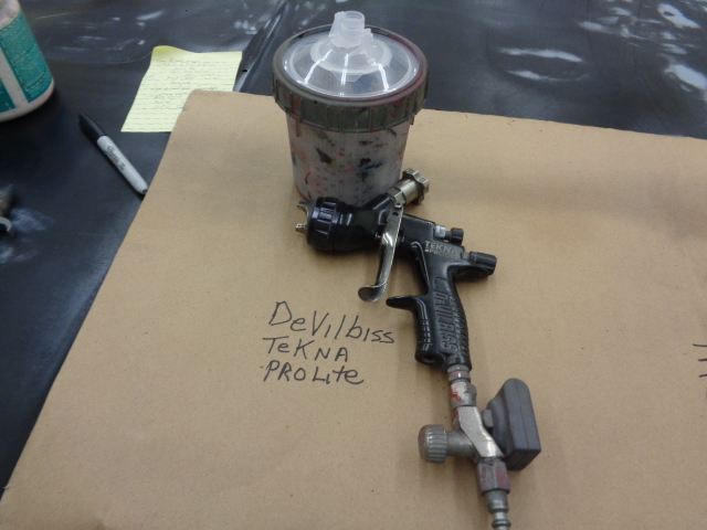

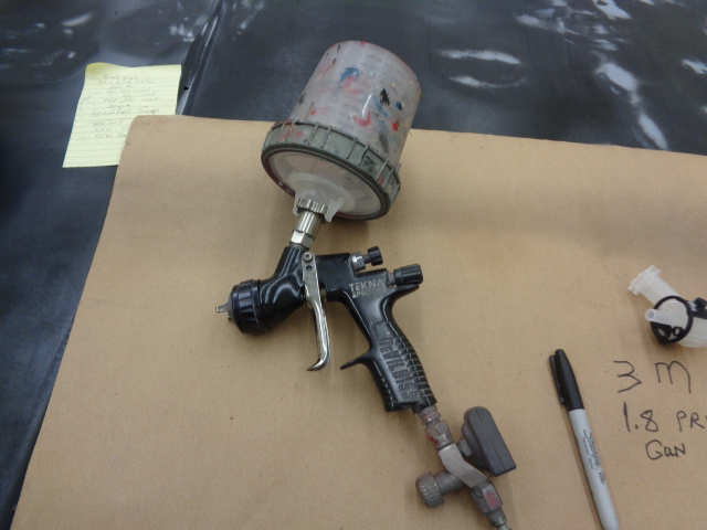

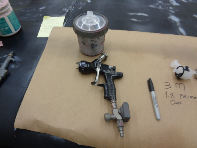

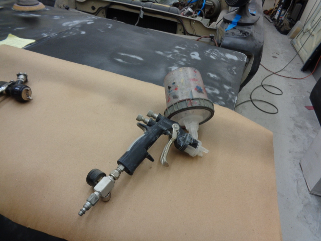

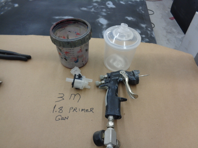

I have different spray guns. my primer gun is made by 3M it's a plastic body with disposable tips and liners for holding paint. it's about $260 for the gun plus the liners and tips. clean up is easy pull the tip off and wipe off the needle and your done. big 1.8 tip good for 2k primers or slick sand sprayable body filler. my b/c c/c is a De Vilbiss Tekna pro lite. max air pressure is 26#'s both guns have a regulator at the gun the Tekna pro is Teflon coated inside and out so clean up is also good but is a little more work than the 3M gun. spray guns 001.JPGspray guns 002.JPGspray guns 003.JPGspray guns 004.JPGspray guns 005.JPG check my threads I painted my 65 satellite in gold poly with these 2 guns.

my tekna pro came with 3 different size tips it's lite weight and has a great spray pattern. clean up is great. my 3M gun is for primers and they have larger disposable tips like a 2.0 to spray heavy primers I've used hvlp since @ 1980 and still have my early guns. the amount of paint you use is @ 1/3 of the old style guns
