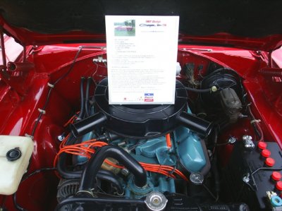

I have a origional air cleaner and spare tire rim.
Both I will have media blasted and cleaned up.
Question:
Should I have them both powercoated or just rattle can paint them black?

The wrinkle finish paint is not the correct for my year b body, just gloss black.
Thats why I was thinking power coat. Would also stand up to the heat in the engine compartment well.

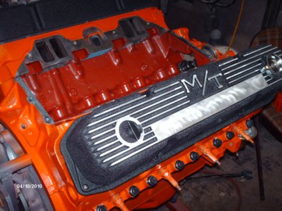

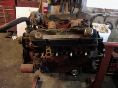

the black wrinkle paint works great just look at my valve covers,anyway if it is just black I would do powder coating.I like the way it holds up.it also helps that I do it on the side
