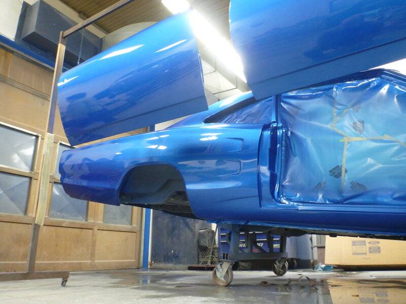

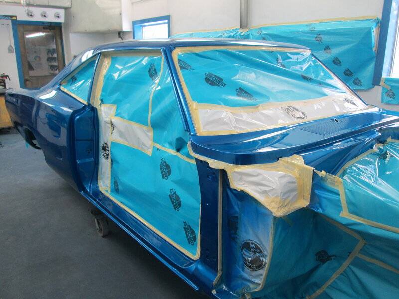

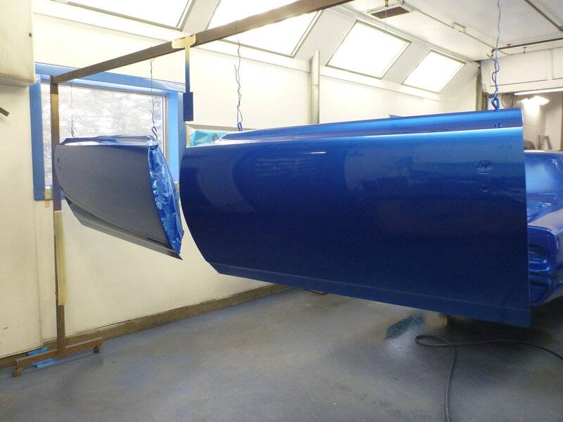

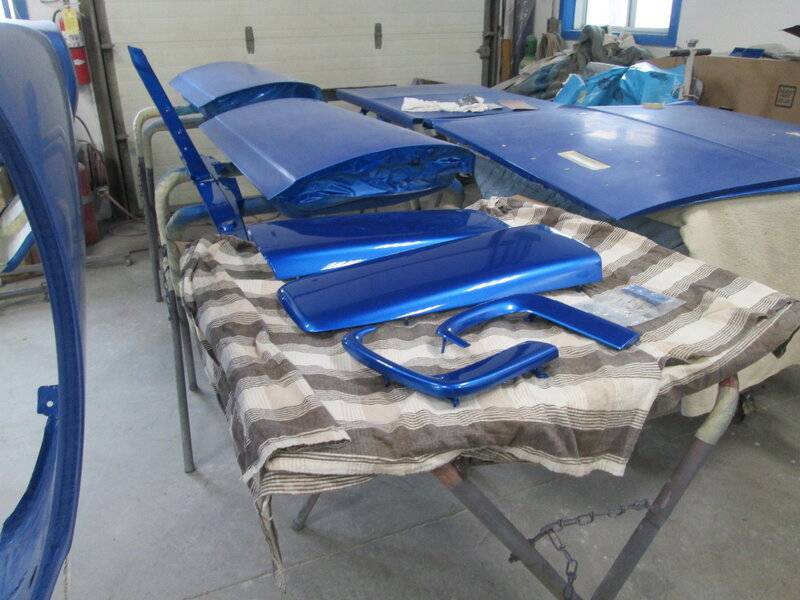

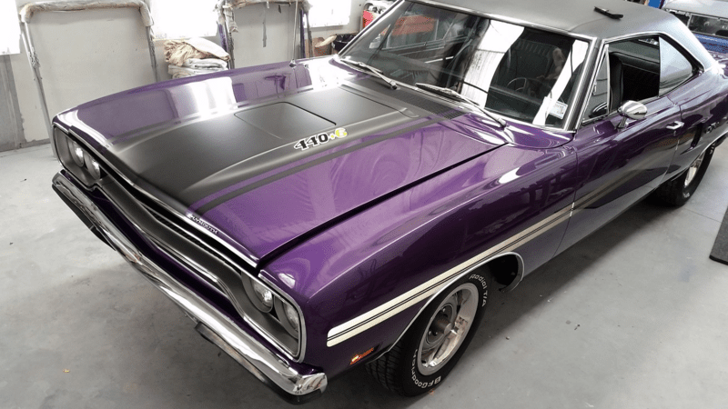

Photo courtesy NZV8 magazine 2002....
Taken late last year.....
