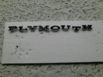

Just did the hood letters on my 67 GTX. I scraped the remaining paint off the chrome with an exacto knife and cleaned the letters with alcohol wipes. I painted the background areas of the letters in gloss black with an enamel paint pen designed to paint on glass. Any excess paint was carefully removed with a rag and a minimal amount of laquer thinner. I then baked these in an unpreheated oven at 375 degrees for 40 minutes as per instructions with the paint pen and let them cool in the oven.
For larger pieces such as a tail panel, I would spray paint and remove the paint from the chrome with either a rag and minimal laquer thinner or remove the paint from the chrome or stainless with very fine steel wool once the spray paint has been given a chance to dry but not harden.
I am sure the parts supplier had a more sophisticated high production method, but you have to work with what you have got. I had King of Trim in CA. repair, polish and paint two headlight bezels and it was $500 plus shipping both ways. I am sure their paint was a meticulous tape off process.

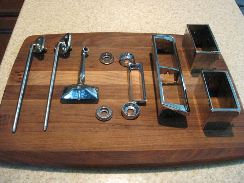

I just got three bids for chroming these 9 parts. Low was $685, middle was $800 and high was $1400. No guarantees of quality since mostly pot metal. Sweet Jesus, that is a lot.
