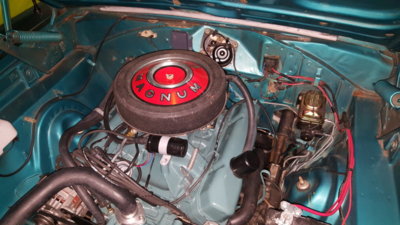

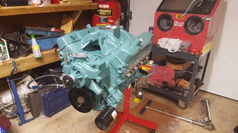

Been almost 2yrs now, still looking good to me ! No primer used, a quick scuff with some 320 grit, wipe down with surface prep/ cleaner and a good coat of Bill Hirsch engine paint ... no different than doing any other smooth surface, valve covers, oil pan, timing cover .....
