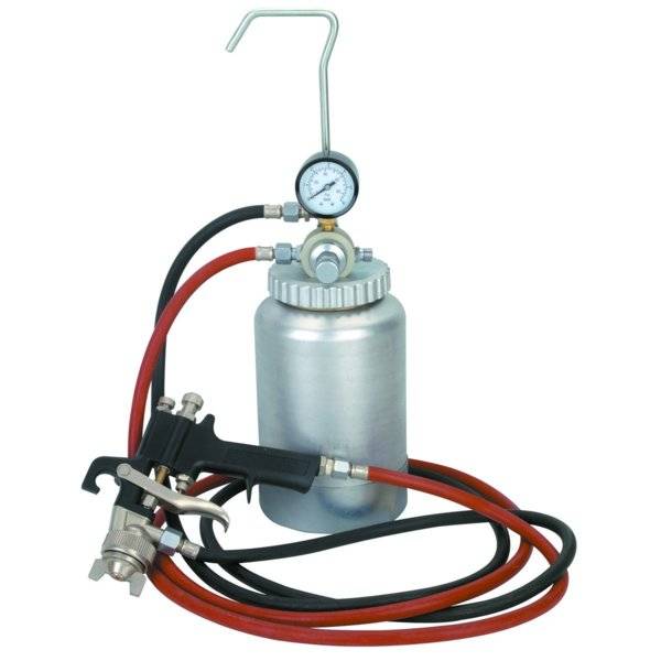

For spraying out of position you'll need a pressure pot to feed the gun. I know what
you're going through! you'll have a lot more room because you won't have the cup
in the way, just the hoses. Good luck!
Here's a cheap one from Harbor Freight!
