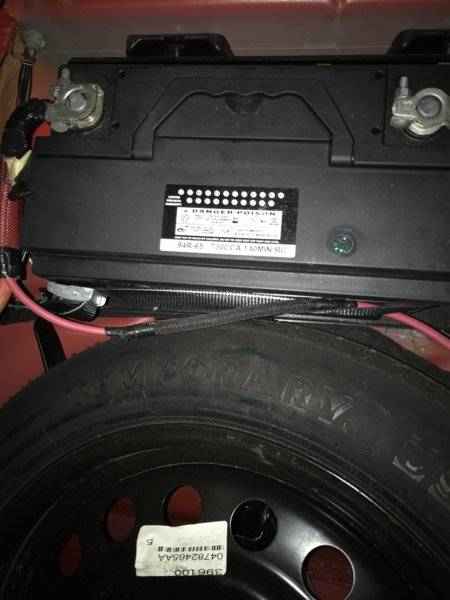

Daytona. 2 owner 54k. Battery 2 years old. This is a second round. Two years ago thought to be the Center Stack. Replaced it. Car parked 3 weeks and started right. Now can go dead in 24 hours. Reads about 9v and trickled brings it right up. Shop is troubleshooting. Very time consuming, check one circuit then wait 20 minutes for it to go to sleep. Thought we heard the rear seat DVD cycling like trying to eject so we pulled the fuse to try that. Also, the red light that blinks normally when alarmed at a faster rate or I didn’t notice it before.
For some time the alarm goes off when opening the trunk without first unlocking the central control. Looking for ideas. Linda shopped a 50k Scatpak and I’m afraid she’ll bring one home. She said it was loud and rode rough. Think it was in sport mode and she didn’t know it. Thank God.

Dennis,
We still have our 07 also with very low miles that we bought new and had all that crazy crap happening plus dash lites flashing and intermittent times, and battery was 1.5yrs old, local place I go to couldn’t correct it, finally I called an old friend who worked for Chrysler in Auburn Hills and he said his tech buddy said that this model was very problematic with battery current changes and to replace the battery with a better one.
Once I did, my problem was eliminated, I know it sounds too easy a fix but it worked for us
