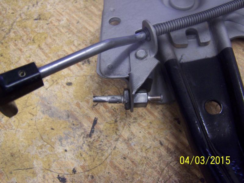

I can't find any information on this. I have all the wiring, the switch but maybe missing a mount bracket for the switch ? Since this was an option for 1964 & up vehicles do the parking brake assemblies differ with or without option ? My thinking is no, just a switch, wiring and dash indicator lamp was added.
Any help would be appreciated
thanks
The switch mounted on the eb bracket! Small hole drilled in it is where the switch mounted!
You are probably missing the mounting bracket. Here is a pic. I may have a bracket if you need it. Not sure
