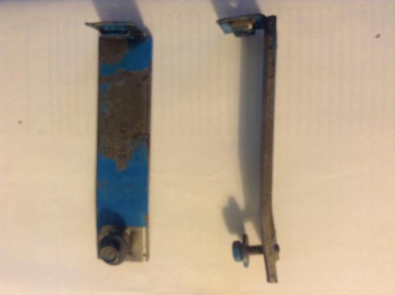

Hey anybody knows ,two brackets and i dont remember where
To put it (73 charger).maybe AC coolant to support ? Number
388M35 i try find parts catalog ,no matching. Thank you.
I check old picture AC brackets have long holes to help adjust .that pair is only parts
I dont have named...

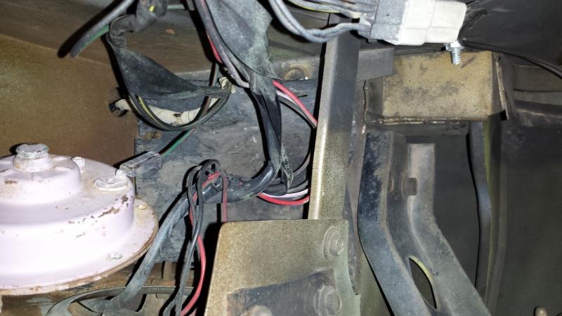

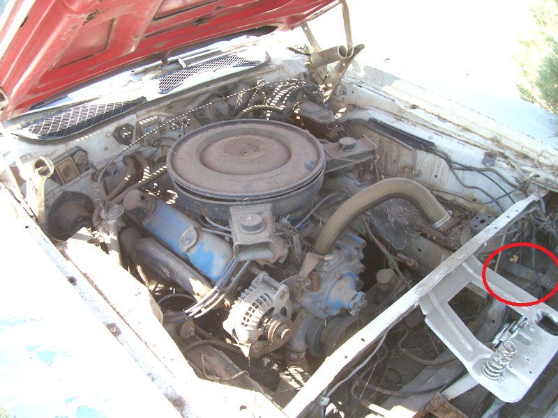

To me they look like headlight assembly support on fender to radiator core support
pic... hard to see but check the red circle
I'd have to agree with Nacho. They look like the headlight bracket support. It should bolt on the headlight frame assembly on the straight end with the 90 degree end bolted up to the radiator core support. Hope this helps. One used on each side.

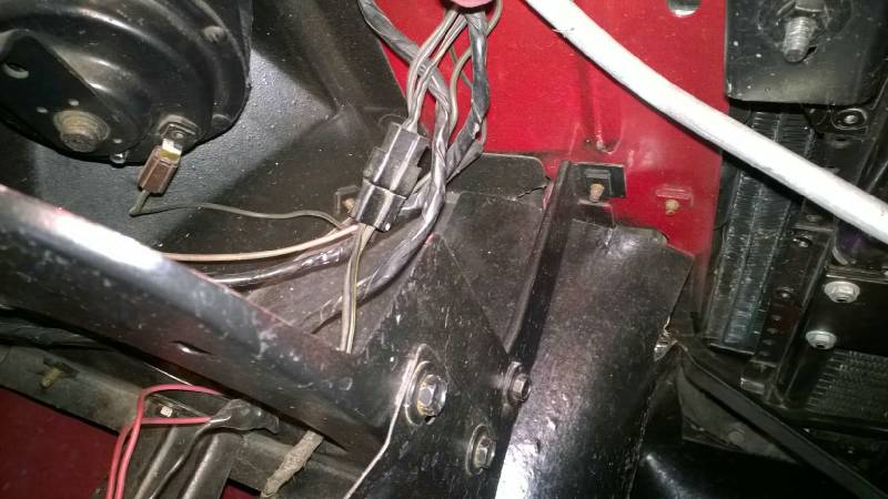

Let me correct myself. H/L bucket mounting brackets. Plymouth has them. Pretty sure Charger does too. Have a set from a 72 Coronet and can check my 72 Charger tomorrow.
Yes it is .thanks everybody to help.
