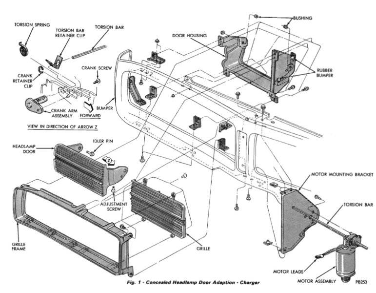

Is adviced to use 71/72 hideaways cars headlight buckets since the are shorter to get more clearence for the headlight doors, BUT has being prooved is not mandatory.
I can't recall at this moment if there is some horizontal bar reinforcement needed. I think not
Of course remove all the standard grille brakets
And of course all the wiring and relay ( a standard 5 pins bosch relay can be used too ). Wiring can be home made even is being sold around.
On dodgecharger.com has being posted this many times. Will try to grabb one of the threads and post.
Mostly sure will find the factory diagram around too

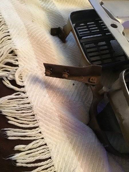

here a rear view of the hideaways assembly... my ONLY DOUBT could be the top bumper reinforcement, because the provision to the doors bracket assembly on inner top bolt. I'm pretty sure 73/74 also have this provision, but unused

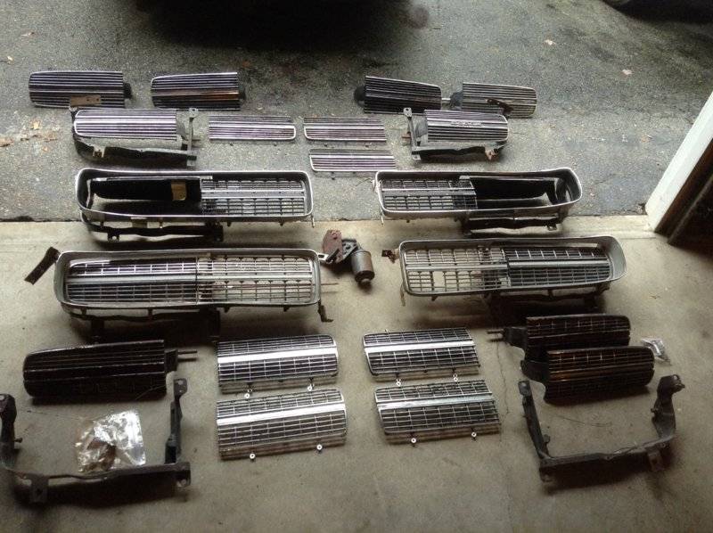

Hijinx, Here's my stash of hideaway stuff. I'd be willing to sell either of the complete 72 setups. I don't think I'd be willing to sell The 71 stuff, it only came out to uncover the 72 setups. Let me know. Thanks, -Tom
I have a headlight harness out of a 72 if needed
Warms my heart to see FBBO stand up to help this guy out. Good stuff fellas, good stuff....
hey sir, do you still have the 1972 hideaway headlight setup?
The best set Sold locally a few months ago. Pretty sure I have 2 complete sets left. Be back in a bit...Headed out to the garage to take a look around.
EDIT.... Yes, there is 1 ok set, 1 nice set that someone had done a black theme on, And lots of pieces parts as seen in the above photo.
